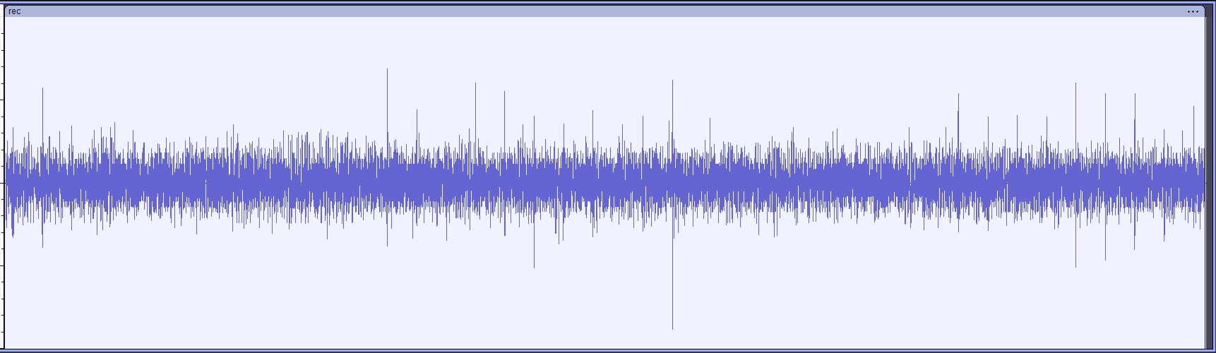

The image shows an amplified recording. It is recorded in AMR format. However, it also occurs in WAV and as a binary (raw) array.
The vertical lines are these clicking noises that are always present in the pattern.
