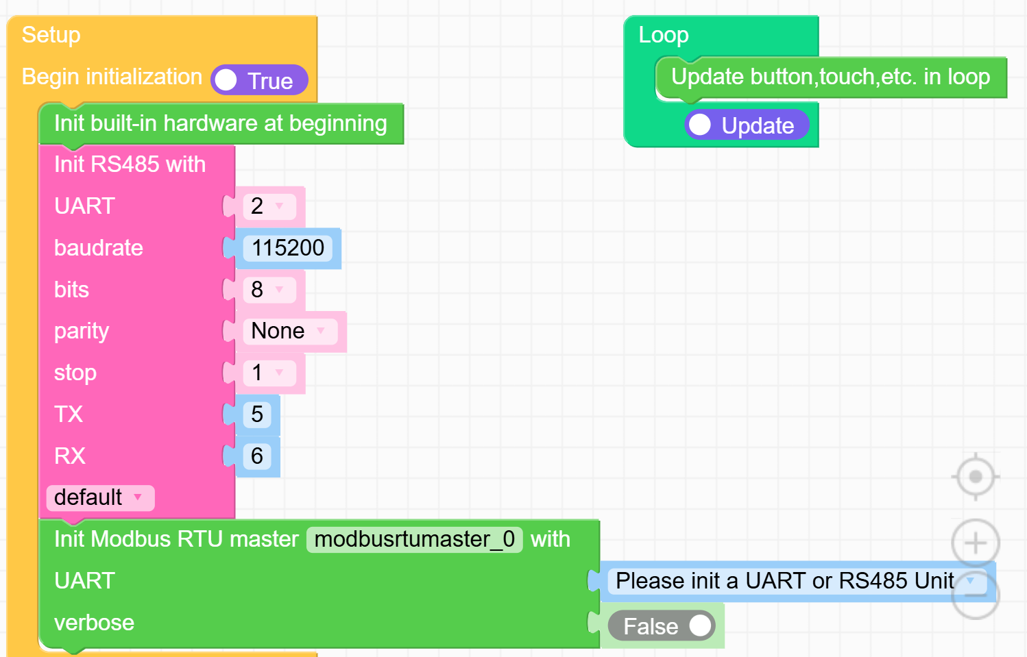

    In UIFlow 2.35, the Atom Base485 block does not expose the uart variable required to initialize Modbus RTU.

      Code produced is:
      base_rs485 = AtomRS485(2, baudrate=115200, bits=8, parity=None, stop=1, tx=5, rx=6, txbuf=256, rxbuf=256, timeout=0, timeout_char=0, invert=0, flow=0)
      modbusrtumaster_0 = modbus.ModbusRTUMaster(uart=_, verbose=False)
      The Base485 init block dose not return a variable, so custom code is required to init modbus.
      Am I missing something?
