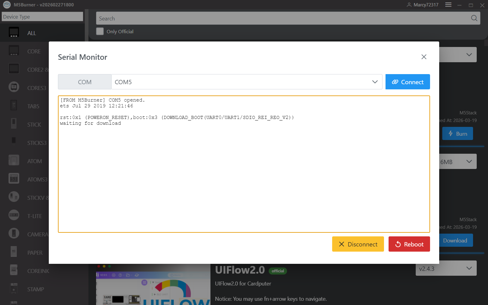

              • robskiR
                robski @Marcy72317
                @Marcy72317 is there any messages on com port monitor in M5Burner you see on this device?
                M5StickC, M5StickCPlus, M5StickCplus2,M5GO, M5Core, M5Tough, M5Core2, M5 Demo Board, M5Dial, M5Paper, M5Atom, M5Cardputer, M5StampS3, CoreMP135, StamPLC, AirQ, M5Tab, M5CardputerAdv
                M 1 Reply Last reply Reply Quote 0
                • M
                  Marcy72317 @robski
                  @robski i don't see nothing

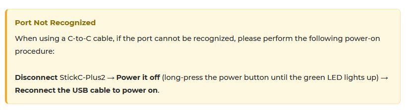

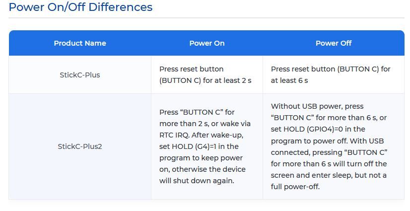

                  • robskiR
                    robski @Marcy72317
                    @Marcy72317 could it be in sleep mode?
                    can you properly switch it off and on then try easyloader?
                    • M
                      Marcy72317 @robski
                      @robski tried holding for more that 6 sec, still nothing, i can't really tell if it is in sleep or on or off since the screen desn't lights up.
