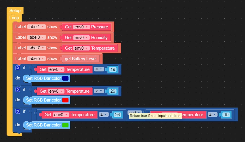

      this program works in online mode
      does not work when downloading
      Can someone explain to me the reason

          I have the latest firmware and UIflow versions installed
          I can't download the code to m5Stack, it gives error
          But the program does work in online mode
          I use the offline version of the program.
          I have the m5stack connected using USB

            almeriBOT @almeriBOT
            https://youtu.be/xDrovPcZMFM

              @almeribot That is wierd,
              I don't have the fire so I cant do a full test but I will try out the code posted above later and see what happens.
              Thank you for making the video, that really helps.

                @almeribot did you have setup device to the USB mode? you need select USB mode , then you can use the offline version UIFlow

                  @m5stack Of course, I use USB Mode

                    @almeribot said in m5Stack Fire. UIflow. Simple program:
                    Hi there,
                    in some case small debug session is req, please download the program and then close the Offline ueflow. connect the Fire to usb and check what you have on console after connecting via for example putty to Fire COM.
                    In past in my case i was able to see the error, it was one variable missing.
                    please show the console output here this will be a way to see what is wrong.
