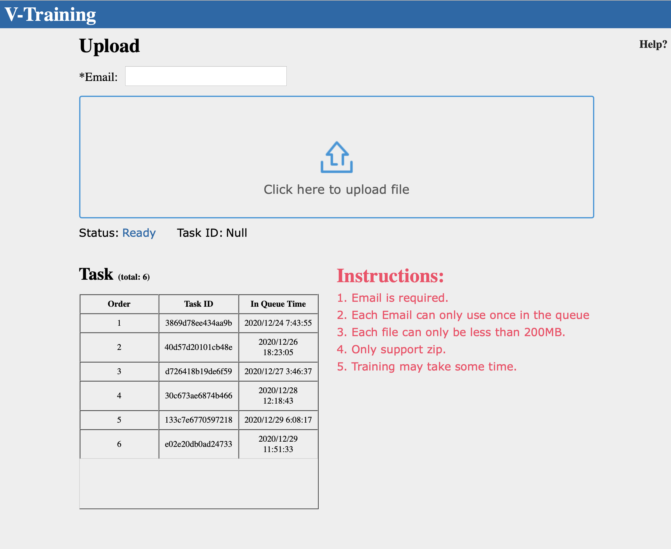

      I uploaded files to the V-Training service but it seems not running....
      Currently Task No.6(2020/12/29) is mine,
      but task No.1 which was uploaded in 2020/12/24 still remaining.
      Anyone can help please?
      http://v-training.m5stack.com
      Thank you.

        @nabeshin said in V-Training Service is active now??:
        Hi, we are aware of that and working to fix it ASAP.
