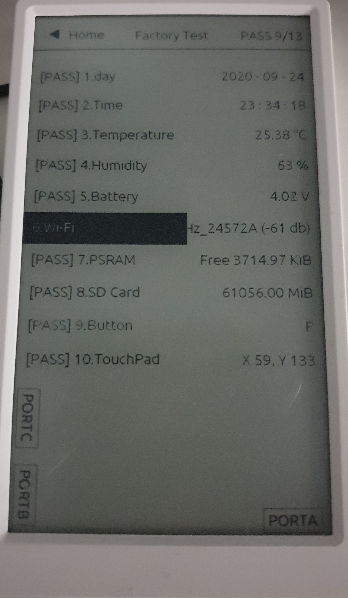

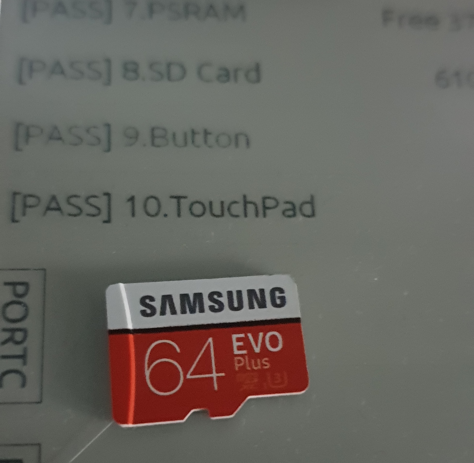

              • MatiM
                Mati
                in my case 64GB is passing test as well.
                K 1 Reply Last reply Reply Quote 0
                • K
                  kevindtimm @Mati
                  @mati I bought 5 16gb cards, tested them yesterday, they work fine. But, I have 32gb that work in all my pc's and my phone but don't work in my m5paper. I did have to use as CS of 4 in the SD.begin() call, this is not documented in the SD_Test example.
