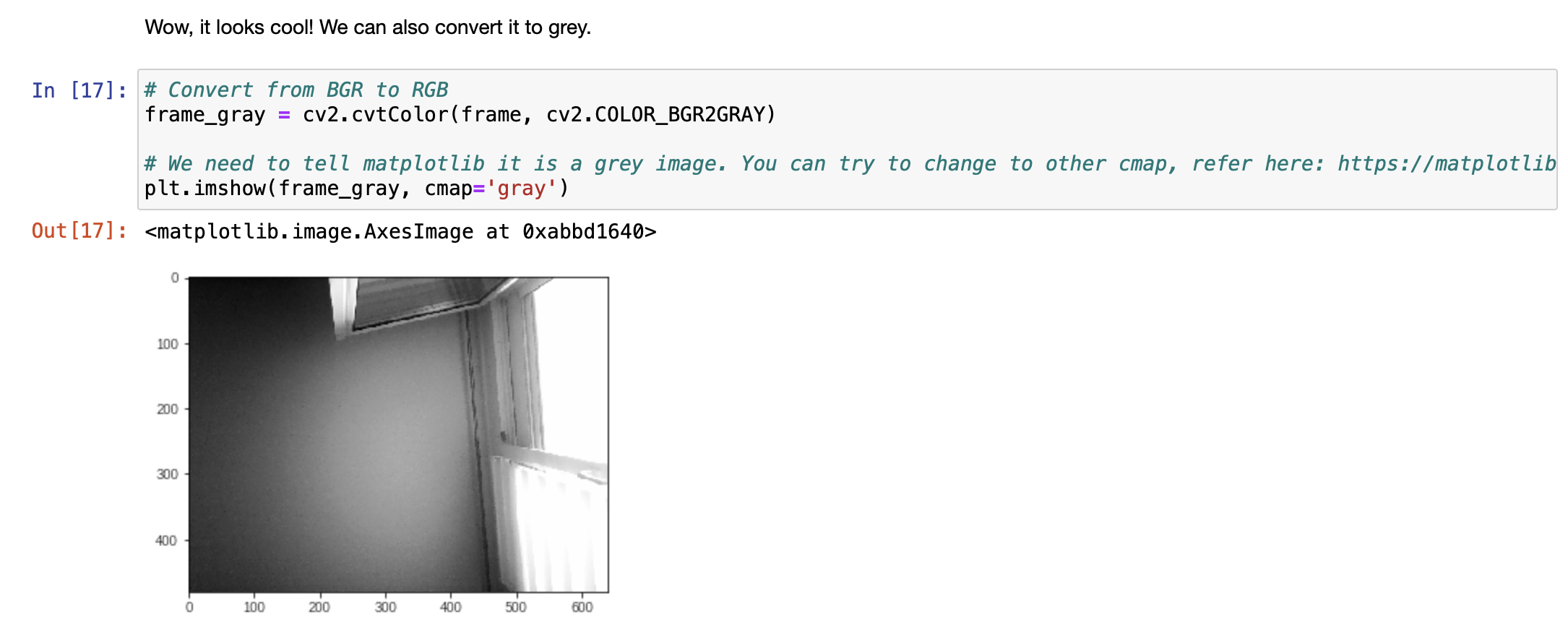

      The new firmware (M5UnitV2RootfsRecoveryPackage-09072021) seems to work fine! In my first test I was even able to connect my Mac to the UnitV2 via wifi. Also the jupyter notebook sample works without problems
      Thanks for providing the update
