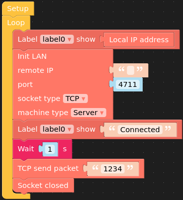

        works for me. Below is a simple TCP LAN server example using M5Core2 which upon connection sends the string "1234" to the TCP client then restarts.
        Note: w/o the 1 second wait I get Ethernet disconnected error.
        UIFlow firmware running on M5Core2 is: 1.9.8
        Thanks
        Felix

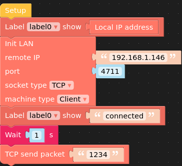

          @felmue It's works with machine type client?
          • felmueF Offline
            felmue
            Hello @jollawat
            yes - below are the blocks I used:
            Thanks
            Felix
