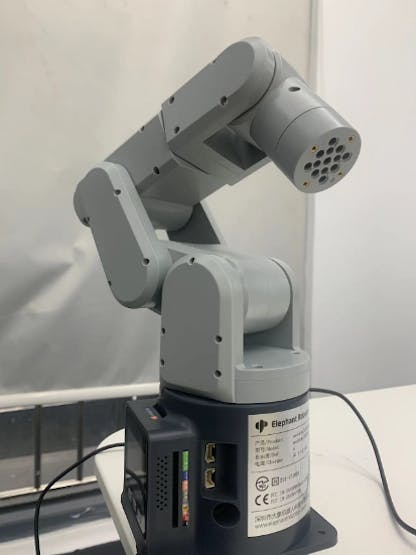

      When I searched for "robotic arm," most of the search results were industrial robotic arms, which were unsuitable for my learning purpose. What I was looking for was a small robotic arm for educational use. And my requirements were:
      • It can be easily installed.
      • High quality with stable movement
      • Sufficient information and tutorials that help me in programming
      After comparing many products, finally I selected the mechArm 270-M5Stack, a small six-axis desktop robotic arm from Elephant Robotics. The mechArm 270-M5 is a multifunctional robotic arm with six degrees of freedom in an industrial design and is based on the M5Stack-ESP32. It supports connecting LEGO firmware at the end of the arm and can be equipped with many accessories, such as a suction pump and gripper.

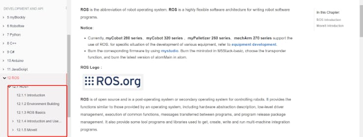

      Also, I got a lot of information about mechArm 270 and many tutorials for programming the robot from Elephant Robotics. Supporting multiple systems and programming languages is also an advantage that attracts me
      The main purpose of this article is to share my feelings and problems in this learning process. I tried to control the mechArm in ROS, the Robot Operating System, which was well-developed as a good choice in robotics learning. Here is my attempt using the mechArm companion material in ROS.
      alt text
      (Gitbook from Elephant Robotics.)
      The environment setup and cases are written in detail in Gitbook, and I wanted to follow the steps on it. When I was installing ROS, it always showed download unsuccessfully, and one solution was changing the download source. Gitbook provided an Ubuntu system with an environment that I could operate directly.

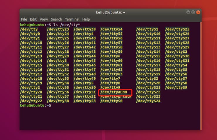

      First, I used USB Type-C to connect the mechArm to the computer.
      Making sure the connection was successful, I entered the command to check.
      ls /dev/tty* //Checking the PC serial connection
      alt text
      When I saw the '/dev/ttyACM0', I knew I had made it.

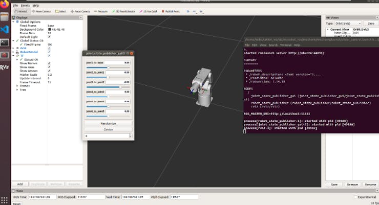

      Next, I used the function described in the Gitbook, which functions as a slider to control the robotic arm.
      In ROS, the Elephant Robotics team has already built the mechArm model and the slider control topic.I only took two commands to make it work.
      alt text
      When I finished running it, I found that my robotic arm did not follow the control slider movement. A 1:1 virtual scene is created in ROS, so another script has to be run to control the robotic arm.
      I've made a video to document it.
      https://www.youtube.com/watch?v=ESRLthJKoyI
      (The shaking of the mechArm in the video is due to the lack of a fixed base, not a problem with the arm.)
      There is also model following, keyboard control, and GUI control.

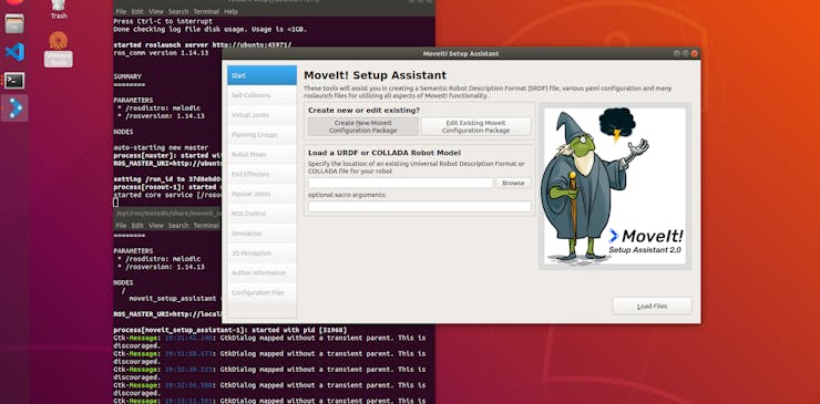

      Slider control, keyboard control, and GUI control are all features of the single-joint control robotic arm, but it is MoveIt that I am most excited about, with its ability to perform motion planning, forward and reverse kinematics, 3D perception, and collision detection.
      When I drag the axis at the end of the mechArm, the mechArm follows the overall movement. MoveIt can generate random poses automatically.
      I also made a video recording.
      https://www.youtube.com/watch?v=EZa6Vek00VQ
      My thoughts and ideas:
      The configuration of MoveIt can be complicated for those who are new to it and don't know where to start.
      alt text
      When I used mechArm, MoveIt was configured and can be used directly, which brings great convenience for programming.
      I saw the configuration information of mechArm in MoveIt, which brought me great convenience.
      The supporting information and data in mechArm is an attractive point for me. It is very useful and helpful for the individual maker who just starting robotics learning like me. Next, I will try to complete the MoveIt configuration of mechArm independently to start learning.
