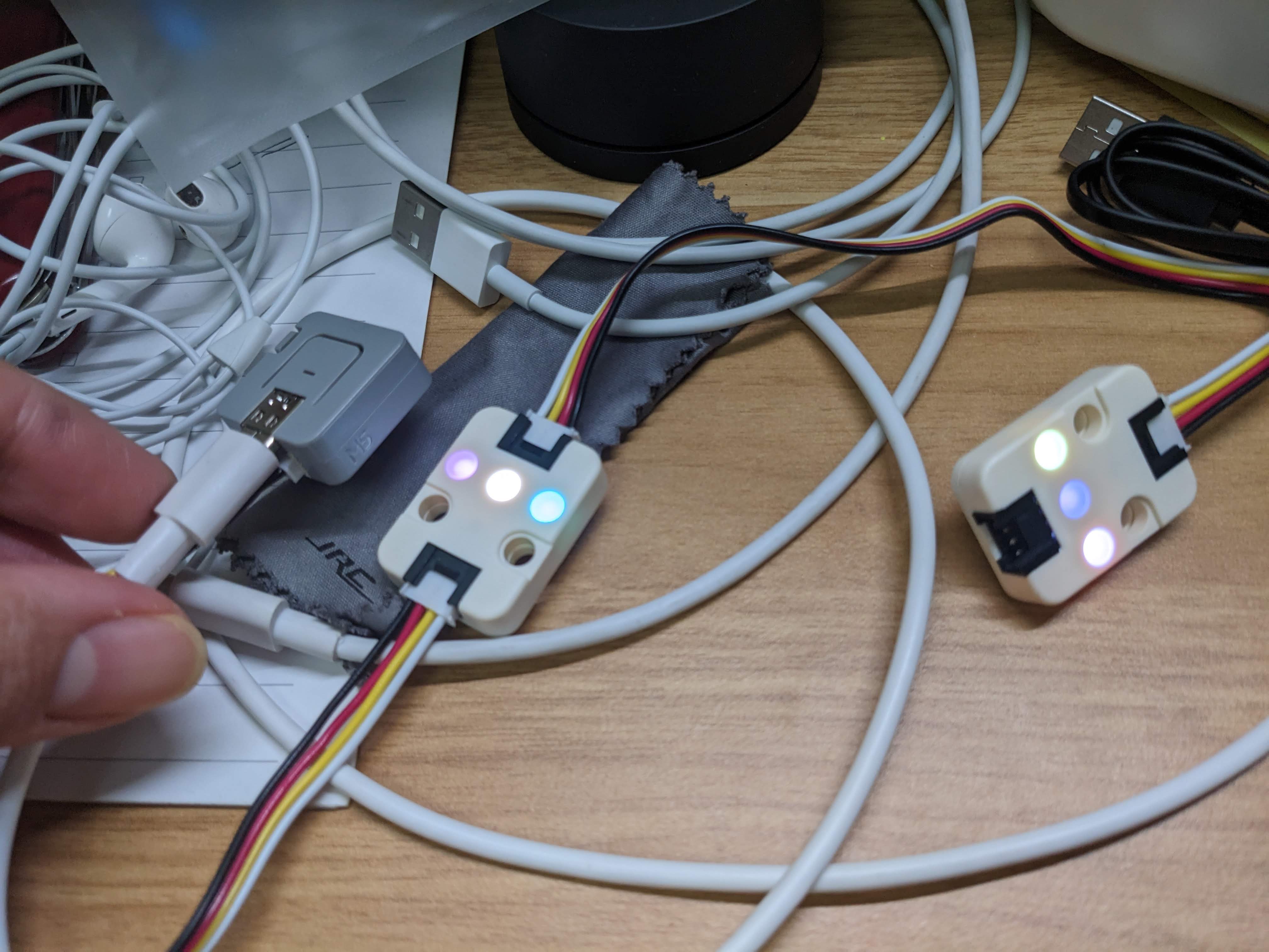

    [Solution] connect 2 RGB unit
    Scheduled Pinned Locked Moved Atom
    1 Posts 1 Posters 2.3k Views
    • D Offline
      dawncold
      import unit
      rgb3 = unit.get(unit.RGB, unit.PORTA)
      # set 1-3 rgb in first RGB unit
      rgb3.setColor(1, 0xffffff)
      rgb3.setColor(2, 0xffffff)
      rgb3.setColor(3, 0xffffff)
      # set 4-6 rgb in second RGB unit
      rgb3.setColor(4, 0xffffff)
      rgb3.setColor(5, 0xffffff)
      rgb3.setColor(6, 0xffffff)
      # if you have three or more RGB unit,
      # you can use 7, 8, 9 as the number
