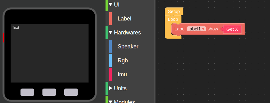

            @jpilarski test it in stick, first maybe i2c error, second will be ok 0_1554774855520_6657dd04-8b24-4500-ac34-4a3c44a2f3bd-image.png

              @jpilarski Its not working using the stick mode in UIFLOW but if you switch to stack mode as @heybin shows the the imu is accessible.
