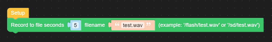

      I recently bought the core2 because it has a build in mic, speaker and much more. Great!
      But I can't get the mic to work in UIflow (online and app) or Arduino IDE. Both the most recent version.
      Even the most basic Blocky makes the Core2 reset when running it.
      It does create a audio file, in my case 'test.wav', but it is 0 bites. Also if i save it to the SD card.

        And yes this simple Blocky record function makes the Core 2 crash and restart.

            I can confirm that trying to record (a 1 second long wav) from the microphone to SD card on an M5Core2 using UIFlow 1.11.8 fails and crashes the M5Core2 with the following error in the debug log:
            [0;31mE (259807) I2S: Error malloc dma buffer␛[0m
            /home/m5/M5-Workspace/esp-idf-for-m5/components/freertos/queue.c:1802 (vQueueDelete)- assert failed!

                @Remco @giftedfinance @djh82uk bug is fixed and the next firmware version 1.12.2 is supported

                    I just tried to record a simple .wav file via the built in microphone on my core2 with the M5Go Bottom2 using the blocky 'record to file' block. I am using UI flow 1.12.2 on my core2 and yes it does record and I can play the .wav file back but even at max volume of 6 the sound is very faint.
