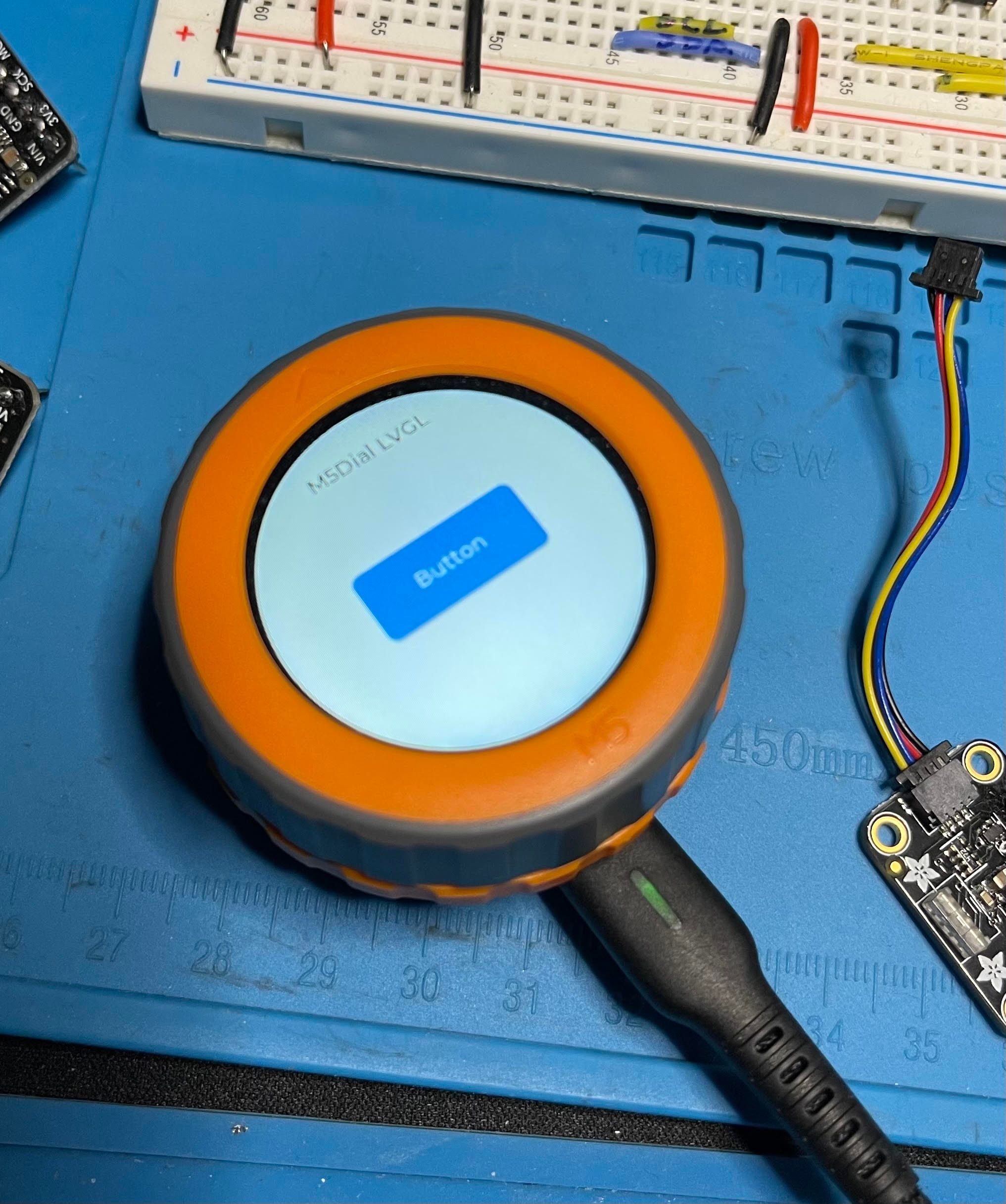

      Does anyone know the correct pin assignment for the M5Dial SPI bus? I am trying to run LVGL with TFT_eSPI. I have tried the pin assignments I obtained from the M5Dial specifications page but I am having no luck. Here is what I have so far
      // For ESP32 Dev board (only tested with GC9A01 display)
      // The hardware SPI can be mapped to any pins
      #define TFT_MOSI 5 // In some display driver board, it might be written as "SDA" and so on.
      #define TFT_SCLK 6
      #define TFT_CS 7 // Chip select control pin
      #define TFT_DC 4 // Data Command control pin
      #define TFT_RST 8 // Reset pin (could connect to Arduino RESET pin)
      #define TFT_BL 9 // LED back-light

                • felmueF
                  felmue
                  Hello @gordsh
                  re TFT_eSPI : try adding the following define in Setup200_GC9A01.h
                  #define TFT_BACKLIGHT_ON HIGH
                  re GC9A01_demo : please find an M5Dial version here.
                  Thanks
                  Felix
                  Code examples
                  • gordshG
                    gordsh
                    @felmue, thanks very much, This worked perfectly.

                          • gordshG
                            gordsh @mukul_100_
                            @mukul_100_ Here is a small demo of the M5Dial with touch and LVGL. Hope this helps and sorry for the delay.
                            M5DialLVGLTouchDemo.ino
                            M gordshG S 3 Replies Last reply Reply Quote 0
