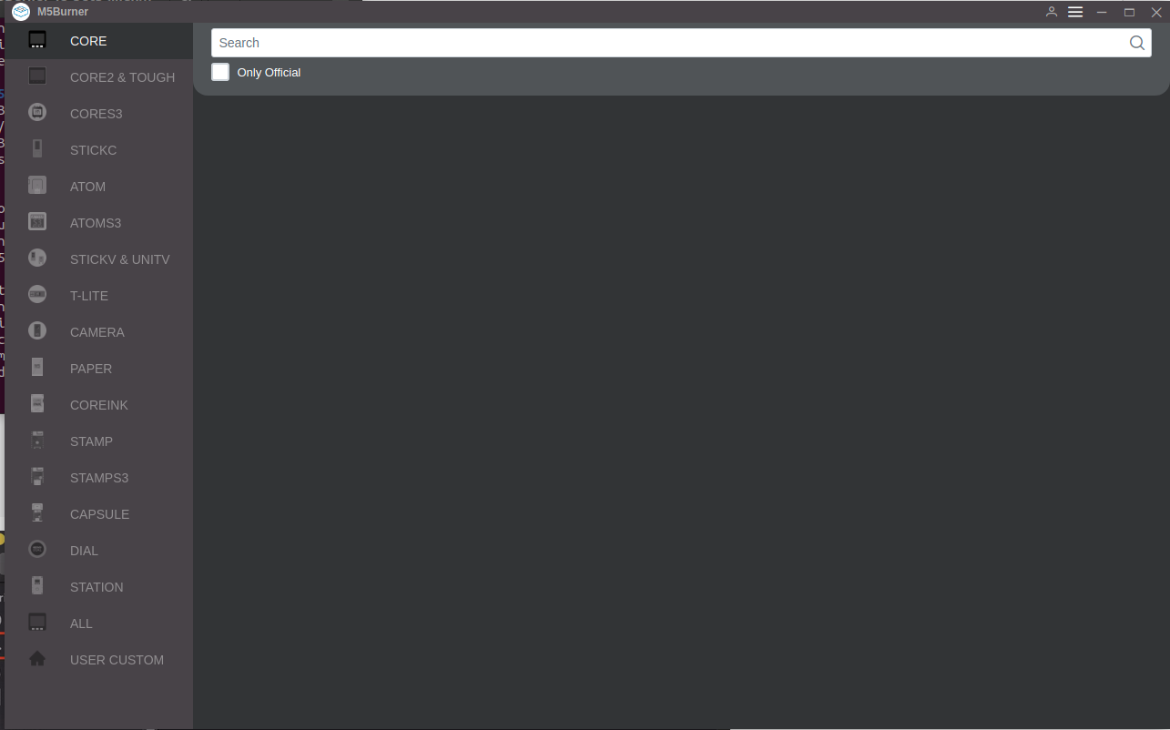

      Hi,
      I try to follow the instruction
      link text
      but the Burner page is black. I cannot do anything. Someone can help me? Thank you!

      ![0_1703855474861_M5Burner.png](/assets/uploads/files/1703855475849-m5burner-resized.png)
      • ajb2k3A
        ajb2k3
        not sure what the problem is as I don't have Ubuntu.
        Have you installed the Arduino+ESPIDF libraries and updated to the latest Python 3?
        • N
          nefasto
          Did you install python3-venv ?
