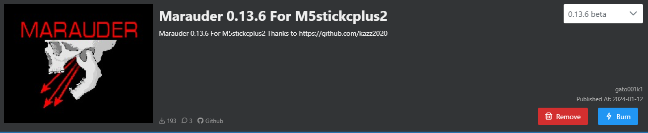

      I can run burn normally, but my screen simply won't turn on, the LEDs also work!
      The firmware
      • ajb2k3A
        ajb2k3 @severopotter
        @severopotter that’s for the plus2.
        You need to erase and re burn UIFlow.
        It’s not the device broken, it the version uses a different hardware configuration

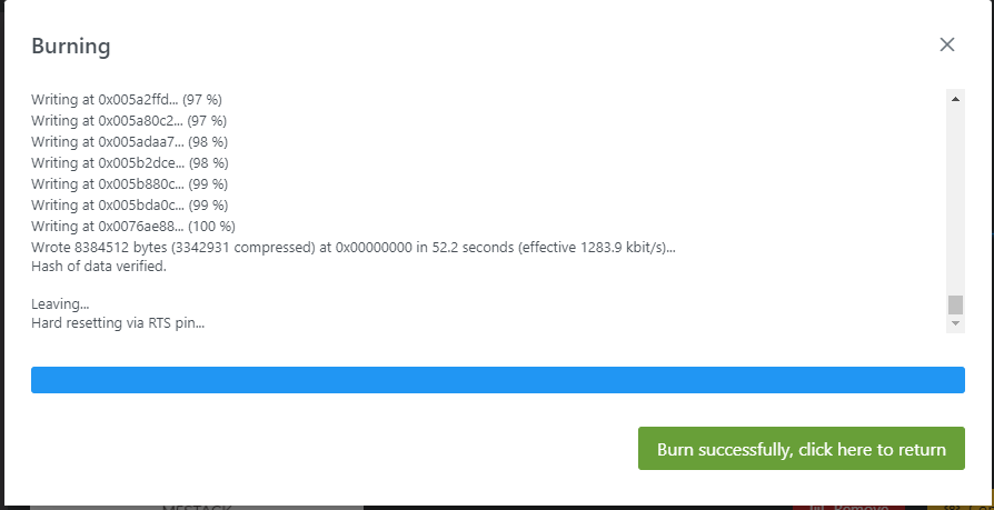

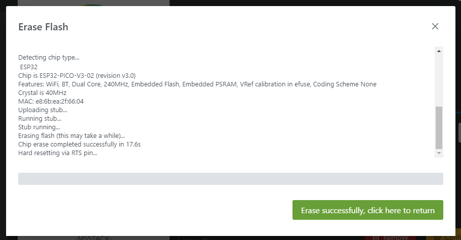

          i've tried erase:
          and burn again

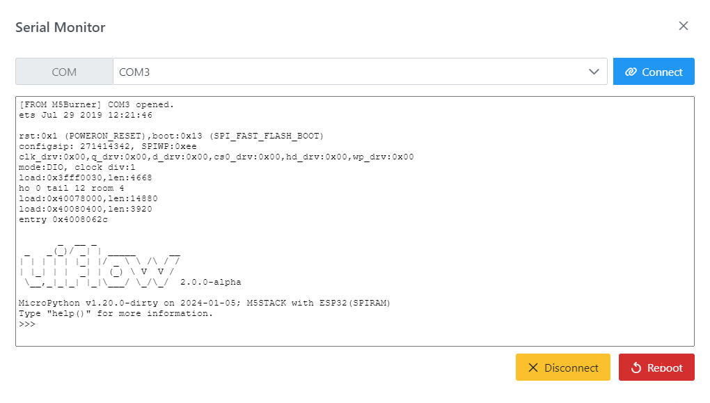

          firmware monitor:
          and it still doesn't work :(
