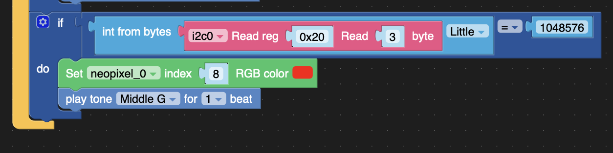

      While I can retrieve the first byte values that give me a value from 0 to 64 I'm getting confused trying to decrypt 2 or more bytes into use full values.
      Is anyone more intelligent able to solve this?
      in the array =
      b'\x00\x00\x00'
      The first byte gives me the values 0 to 64 but then after that, the first byte remains at x00 and then the second byte changes.
      • ajb2k3A
        ajb2k3
        Never mind, I found the missing int from bytes blocks and it works.
