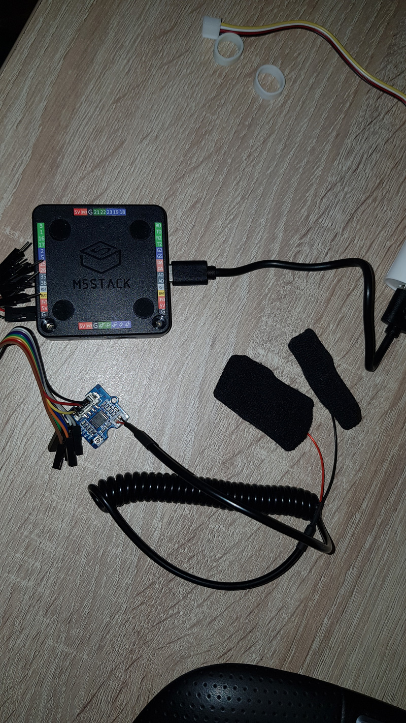

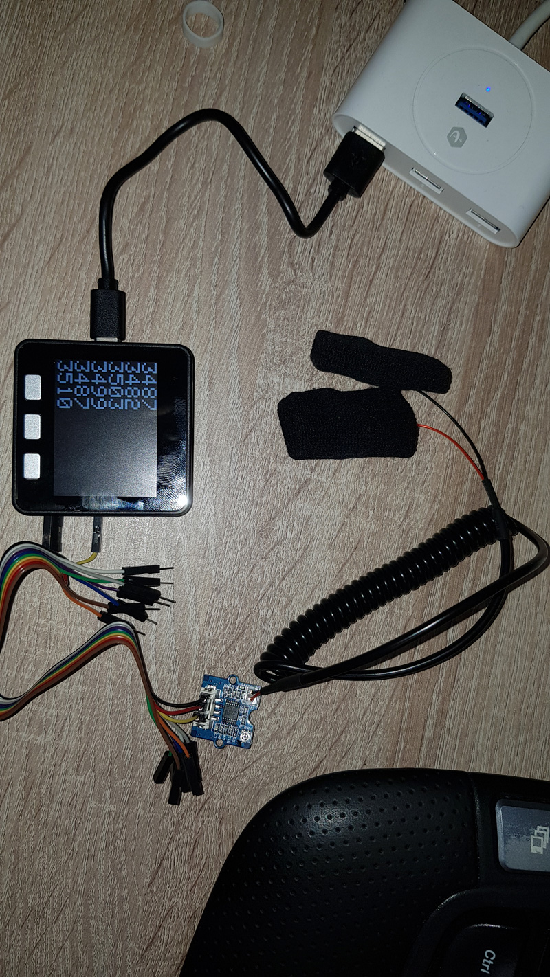

                      • ajb2k3A
                        ajb2k3
                        Can you post photos of your setup please?
                        I curious to how its connected.
                        • R
                          rmarinchev
                          The setup with the m5stack and the esp32 is as you said, just connect to 35 or 36 and read the analog input.

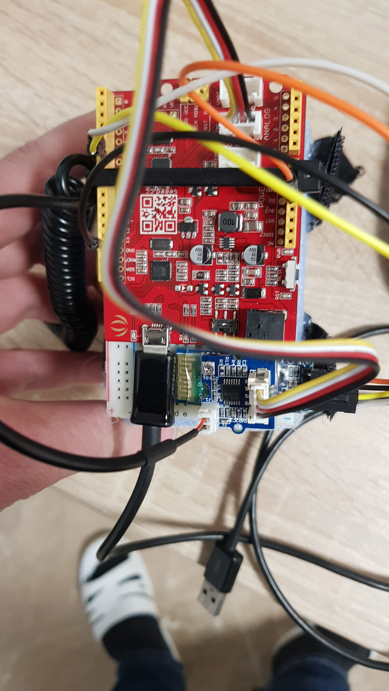

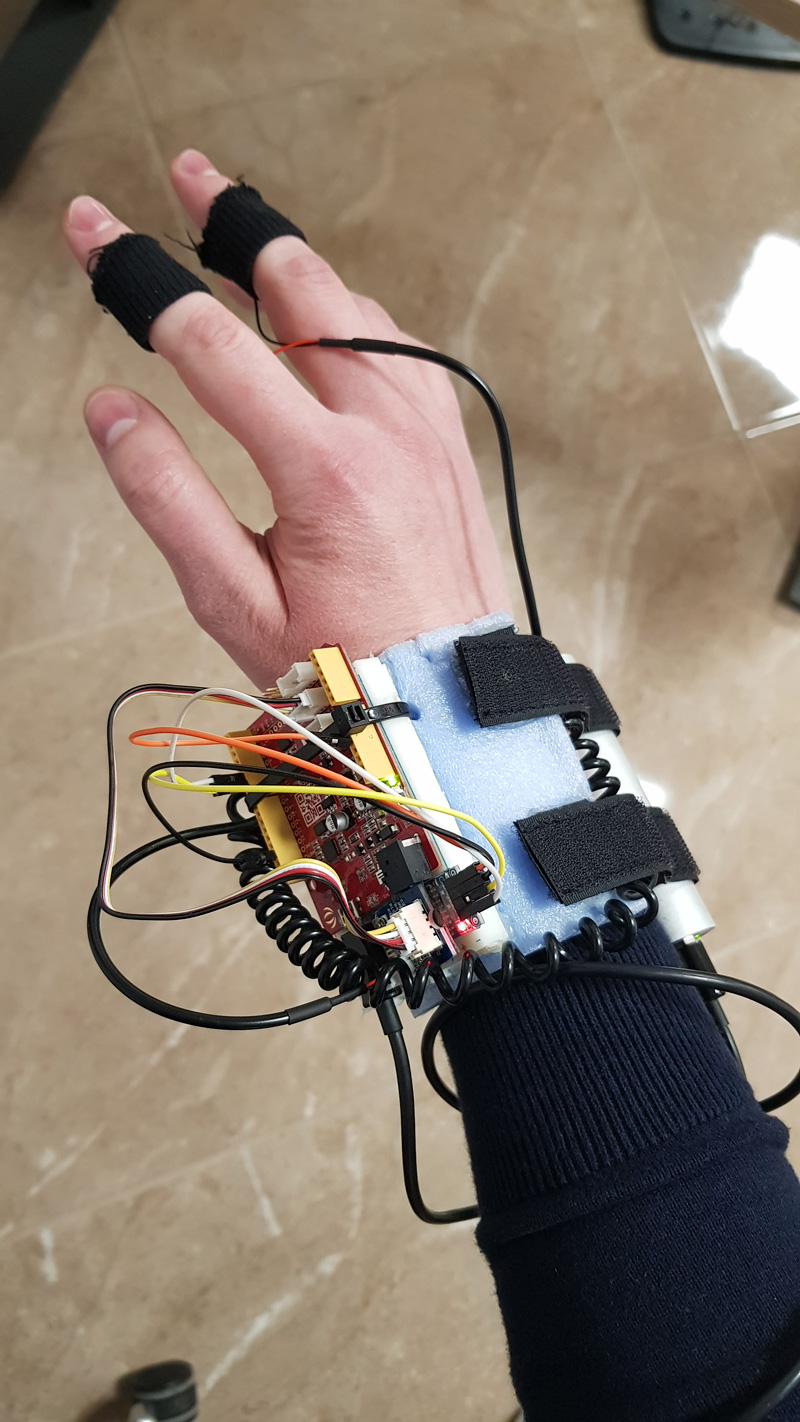

                          • R
                            rmarinchev
                            And the seeedino is pretty straight forward. Here I have also a bluetooth module, since the seeeduino values are accurate, so I am using it as part of my prototype. The GSR sensor has a groove connector that plugs straight in the seeeduino port.
                            • ajb2k3A
                              ajb2k3
                              Thanks for the photos and nice work there.
