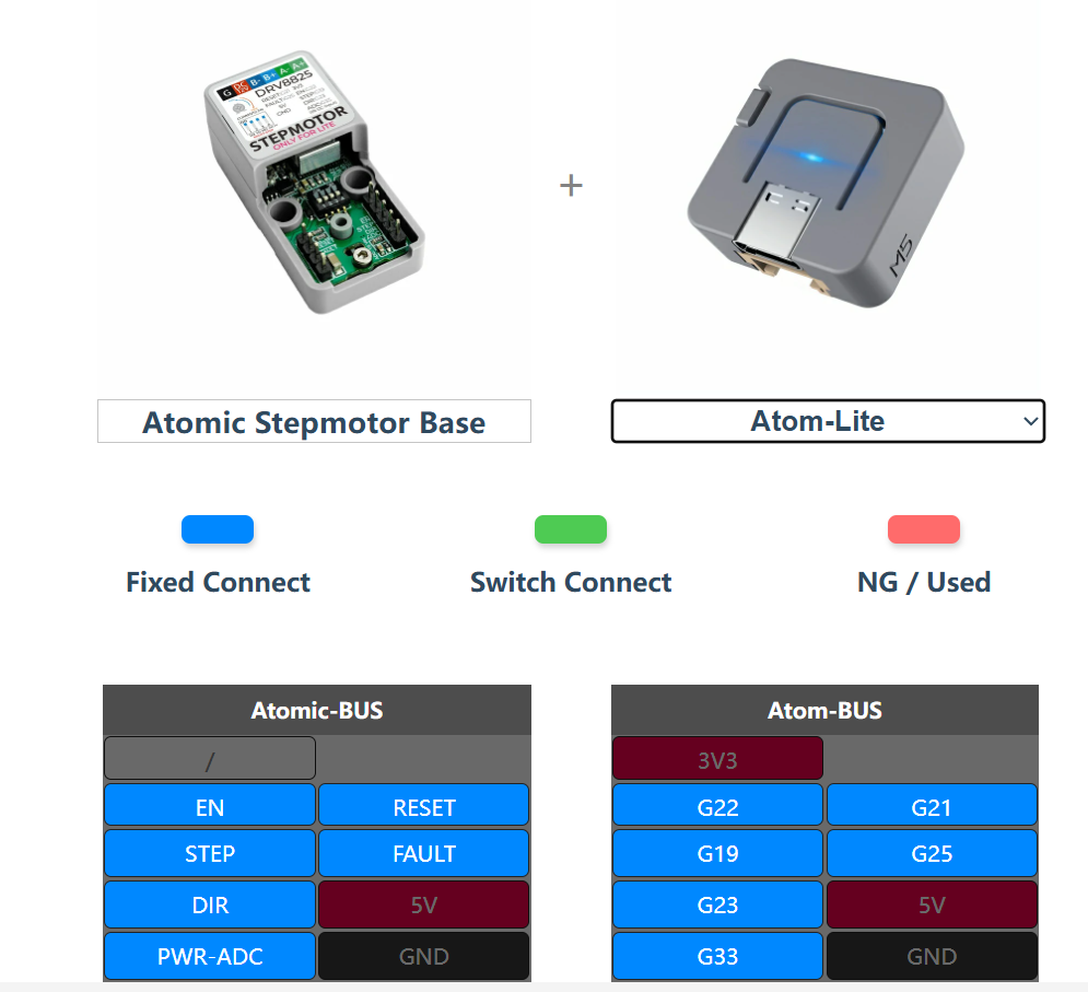

      I am trying to use an Atomic stepmotor base (SKU:A132) with an Atom lite (SKU:C008) Uiflow2.0 (v2.2.8) but it does not work.
      I get this error message :
      File "base/stepmotor.py", line 1, in init ValueError: invalid pin
      I think pins are sets correctly :
      base_stepmotor = AtomicStepmotorBase(22, 23, 19, 25, 21)
      I do not understand why it's throwing error and what i am doing wrong ?

        you are not doing anything wrong I think. The issue is with UIFlow2 firmware for M5AtomLite. As far as I can tell the default pins are for M5AtomS3 (Lite) and there is one additional pin, which cannot be set from the init block and it is set to a GPIO (8) only available in S3. See here.
        BTW: I've created a PR for the issue. So hopefully it will be fixed in a future firmware version.
