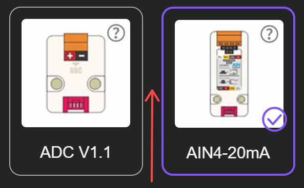

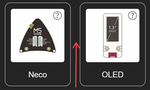

          • M Offline
            montanaman @hacxx
            @hacxx Obviously I am missing something because UIFLOW 2.3.1 lists neither Neopixel nor Addressable LED in the unit list for me.
