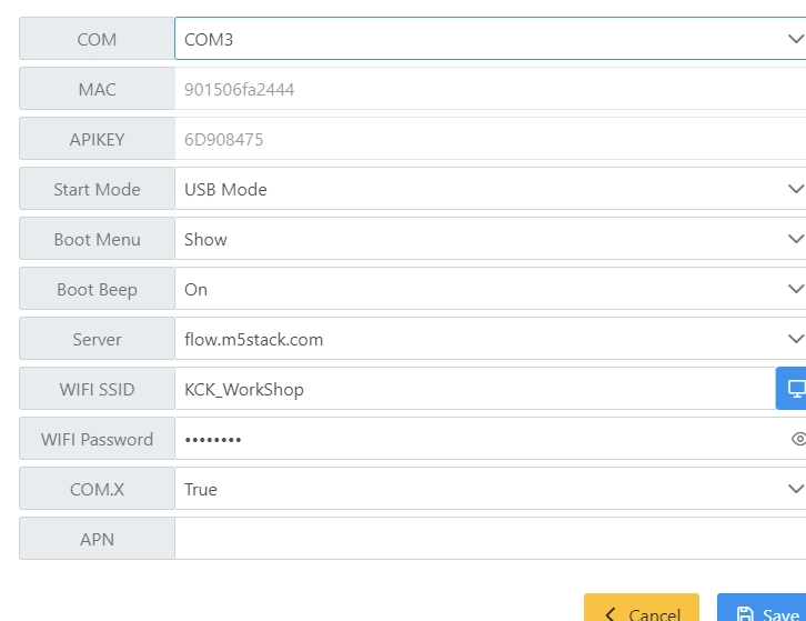

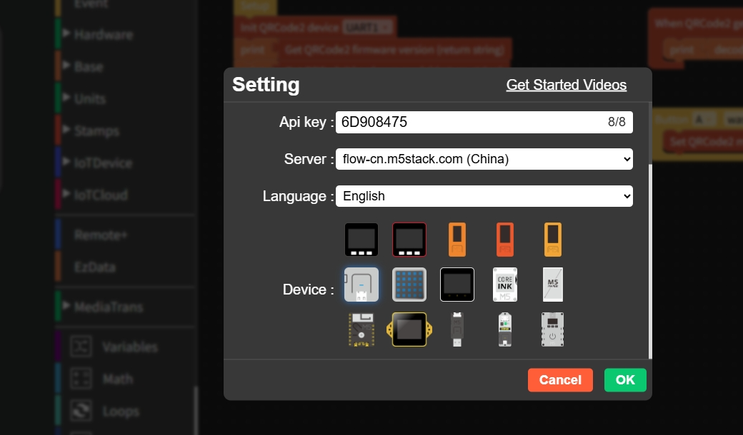

      dingfanshou
      eca22fca-6702-466c-95fe-01cb4e2e8a0a-image.png bd07d0b6-6712-4750-99b2-b2ed504431b0-image.png Why can't it connect even though the password is the same?

        @dingfanshou said in key:
        In the config I see "Start Mode" is "USB Mode". This means, your device is not connecting to WiFi at startup unless a previously stored program does. Change the mode and try again.
