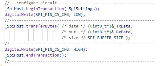

      Similar with SPI:
      this enables CS line, transmits data and disables CS line.
      But this is blocking. Even if SPI frequencies are high and such transmissions are only taking a few 100microseconds. Why is this not done similiar like UART with background transmission and OnReceivedCallback or similar?
