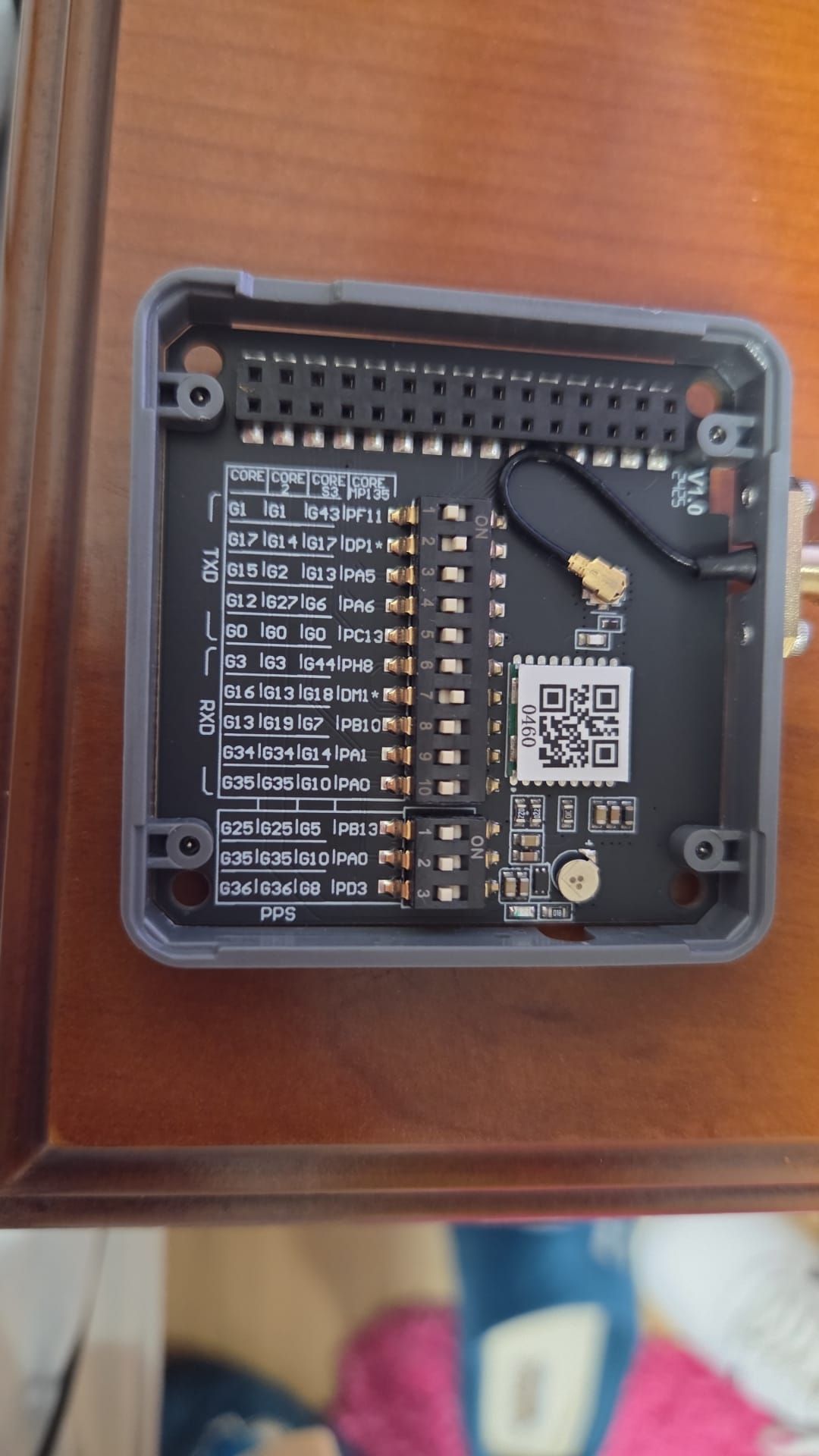

@robski I'm completely new to M5Stack so I'm not sure if this should be working. Here it is:
#include <M5Core2.h> #include <TinyGPS++.h> TinyGPSPlus gps; HardwareSerial GPSRaw(2); void setup() { M5.begin(); M5.Lcd.setTextSize(2); M5.Lcd.setTextColor(TFT_YELLOW); M5.Lcd.println("Test GPS v2.1 - Core2"); M5.Lcd.setTextColor(TFT_WHITE); M5.Lcd.println("Waiting satellites..."); GPSRaw.begin(9600, SERIAL_8N1, 13, 14); } void loop() { M5.update(); while (GPSRaw.available() > 0) { gps.encode(GPSRaw.read()); } if (gps.location.isUpdated()) { M5.Lcd.fillRect(0, 60, 320, 180, BLACK); M5.Lcd.setCursor(0, 60); M5.Lcd.setTextColor(TFT_GREEN); M5.Lcd.printf("Connected satellites: %d\n\n", gps.satellites.value()); M5.Lcd.setTextColor(TFT_WHITE); M5.Lcd.printf("LAT: %.6f\n", gps.location.lat()); M5.Lcd.printf("LNG: %.6f\n", gps.location.lng()); M5.Lcd.printf("HGH: %.1f meters\n\n", gps.altitude.meters()); // UTC hour sync with satell if (gps.time.isValid()) { M5.Lcd.setTextColor(TFT_CYAN); M5.Lcd.printf("UTC hour: %02d:%02d:%02d\n", gps.time.hour(), gps.time.minute(), gps.time.second()); } } }``` -
Issue With Module GPS v2.1 and M5Core2posted in Core 2
Hi,
I've been trying to receive any data from the GPS module connected to the M5Core2. Nothing seems to be working. I've followed all the instructions on the official documentation and configured the PINs correctly. It doesn't receive any raw data, but the blue led in the module is blinking.
Has anyone had this problem and found any solution/any page to further investigate??
