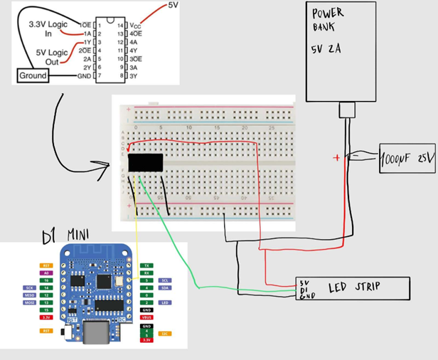

For a university project I am using a Wesmos D1 mini to control a LED strip that has SK6812 leds. https://docs.m5stack.com/en/unit/rgb_led_strip To convert the 3.3V data I use a level shifter and a power bank to supply power to the LED strip directly. The D1 is powered by my laptop. This set up works just fine.

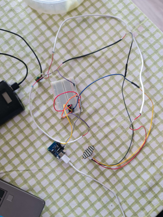

However I have another LED unit a WS2812 LED matrix https://docs.m5stack.com/en/unit/neohex. It has a 4 pin grove output for which I used a Grove-DuPont female conversion cable and connected it to the exact same set up as before. However I could not get it to work neither with Fastled nor Neohex libraries.
What should I check in my setup or what did I do wrong?
(For the code I tried running the same Neopixel code that I used for the led strip but after I made very simple codes as well that only lit up one LED and neither worked)
