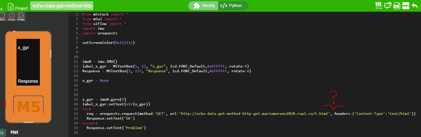

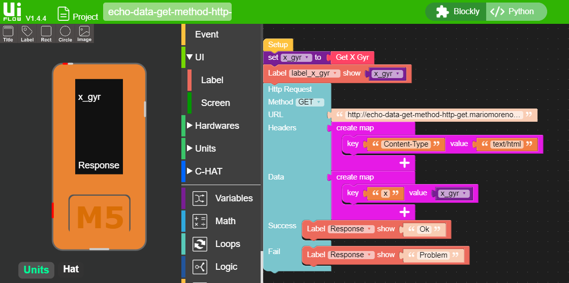

      When I try to send data through http, with the get method, it doesn't send the names and values pairs.
      UIflow with blocks:
      When I look at the code, I don't see it send the string with the name and value pair.
      According to this web page, the program would have to send you the data arguments.
      https://makeblock-micropython-api.readthedocs.io/en/latest/public_library/Third-party-libraries/urequests.html#urequests.request
      I have tried to write by hand, without success.

      And if you want to try the UIFlow code, here is a download link. You can see how in the blocks it sends data and in the python code no.

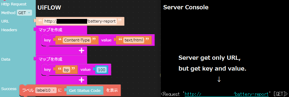

        I got same problem.
        Here is my UiFlow code and server console.
        E 1 Reply Last reply Reply Quote 0

          • E
            epollari @uecken
            @uecken Replace the text box containing the URL with an unescaped text box. That way, the URL won't get truncated. See also this post: HTTP GET query parameters
