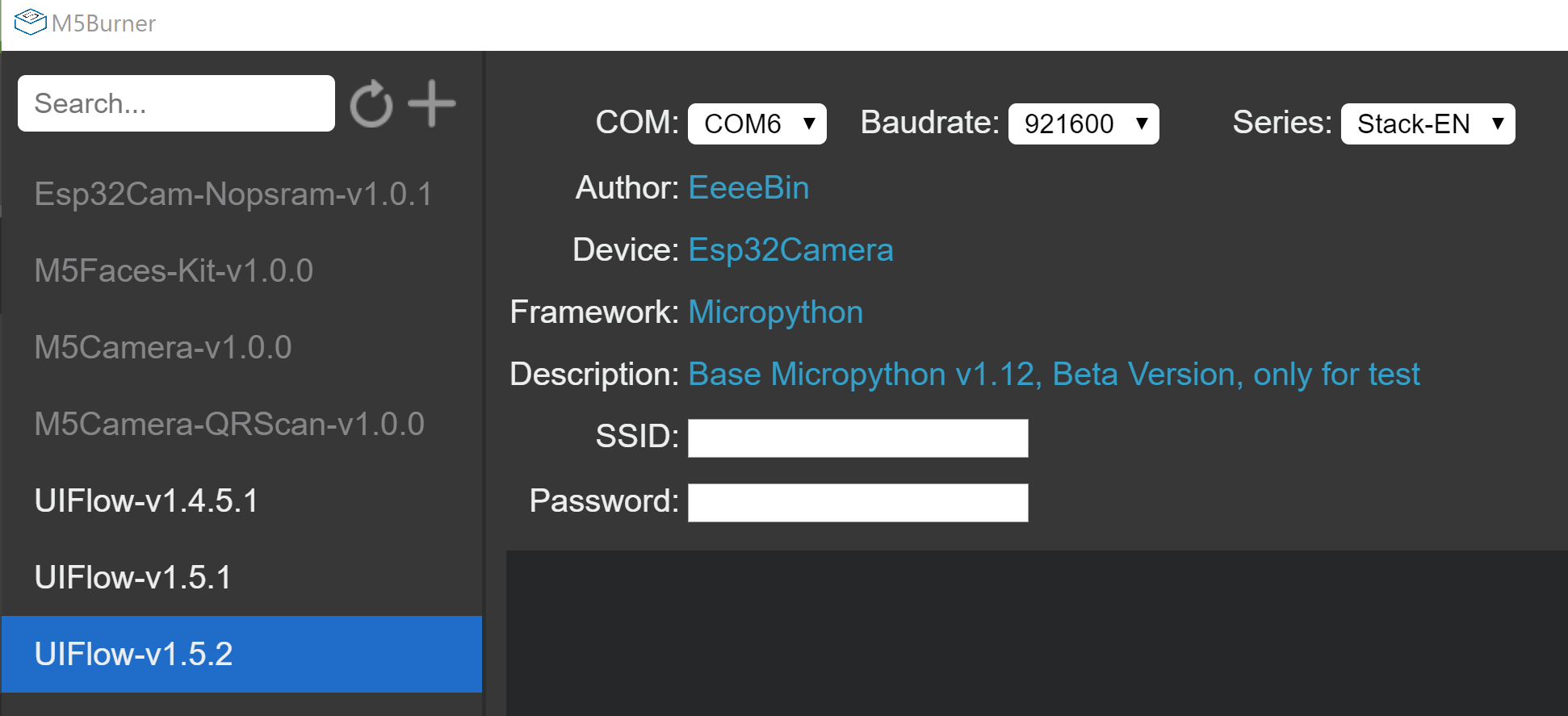

      I have noticed that, when the burner starts up (either independently, or through uiflow), it points to Esp32Cam-Nopsram-v1.0.1, and the Device is Esp32Camera.
      When I click on e.g. UIFlow-v1.5.2, the Device remains Esp32Camera: 0_1590250920084_camera.png
      I found out by accident that it actually does burn the Esp32Camera firmware, because that firmware doesn't support WiFi, and neither did my image. The fix/workaround is to click on the firmware (e.g. UIFlow-v1.5.2) again, and then the device switches to M5Stack Core.
      Caveat burner! :)

        Yeah, I noticed that yesterday as well. I have gotten into the habit of double checking all the settings before burning (com port, baud, series, SSID, etc.)
