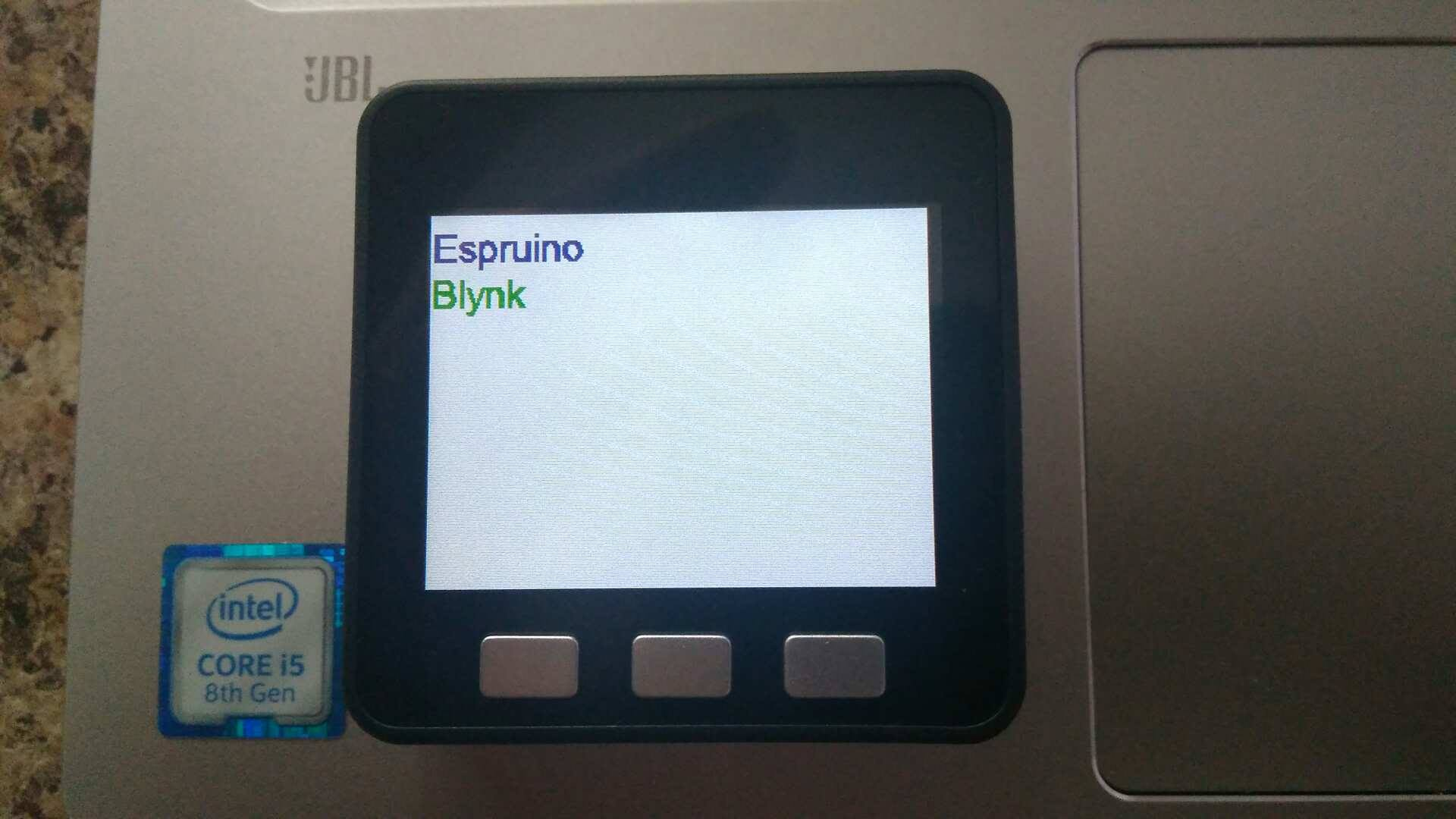

          If anyone is interested in Espruino on M5Stack - check out this initialization code:
          https://gist.github.com/vshymanskyy/49accf6355900346fd1418336d6be86e
          It initializes the display, but currently the display works rather slow due to Espruino limitations (hopefully will be fixed in future).
          Also stops the annoying noise! ;)
