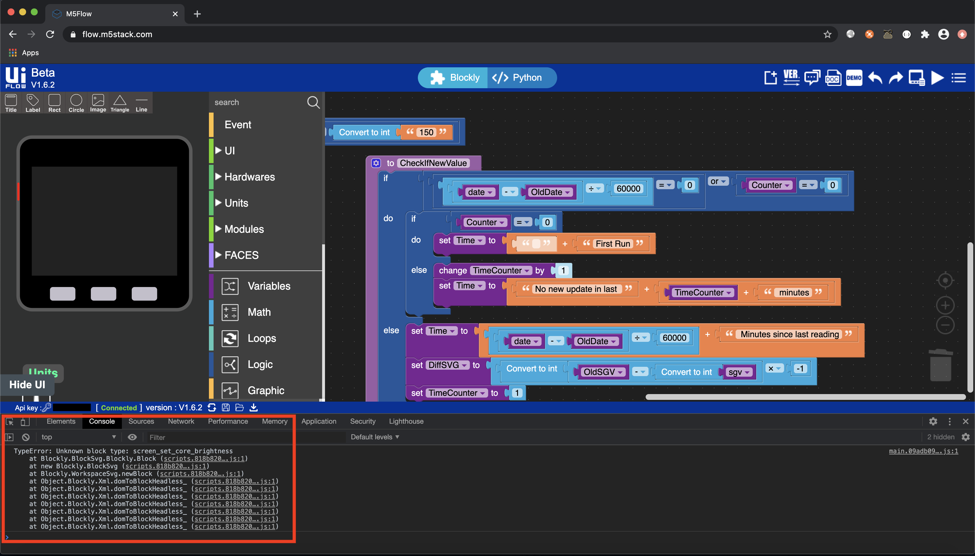

                The issue with @Chris-0's program is because m5stack changed the screen brightness block in recent firmware versions and Chris has not updated it yet on his GitHub repo. Looking at the Chrome developer console when loading the program into uiFlow, I see this...
                TypeError: Unknown block type: screen_set_core_brightness
                    at Blockly.BlockSvg.Blockly.Block (scripts.818b820f5fb58046033f.js:1)
                    at new Blockly.BlockSvg (scripts.818b820f5fb58046033f.js:1)
                    at Blockly.WorkspaceSvg.newBlock (scripts.818b820f5fb58046033f.js:1)
                    at Object.Blockly.Xml.domToBlockHeadless_ (scripts.818b820f5fb58046033f.js:1)
                The block changed from screen_set_core_brightness to screen_set_brightness. I fixed the file for you and now it loads properly in the online uiFlow IDE v1.6.2. You can find the modified file here.

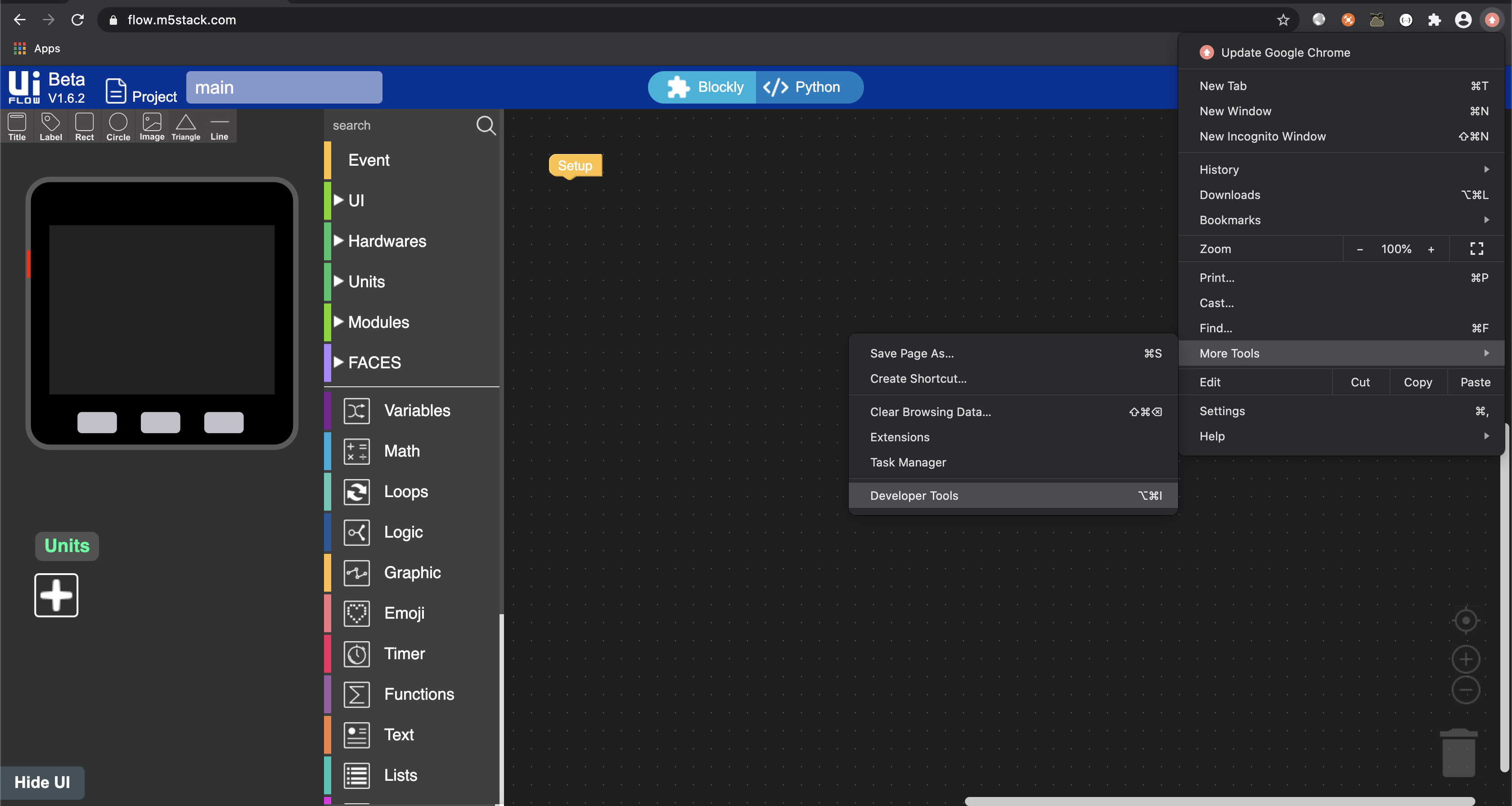

                    Can you try the Chrome browser and turn on the developer console to see what error it's throwing? Also, did you try the beta uiFlow v1.6.2?
                    Another way is to copy this python file to your device and place it in the /flash/apps folder. Then after boot up, go to App and select M5Scout-fixed.py from the App List. Don't forget to change the wifi ssid and password before copying the file to your device.

                      For reference, here is a picture of the error in the Chrome developer console on the original (non-fixed) file...
                      Turn the developer console on:
                      After I open the file in uiFlow:
                      The file at least loads partially. I'm seeing some blocks, but none of the UI labels are showing up on the UI simulator due to the error. So check the Chrome developer console to see if there are other errors you see.

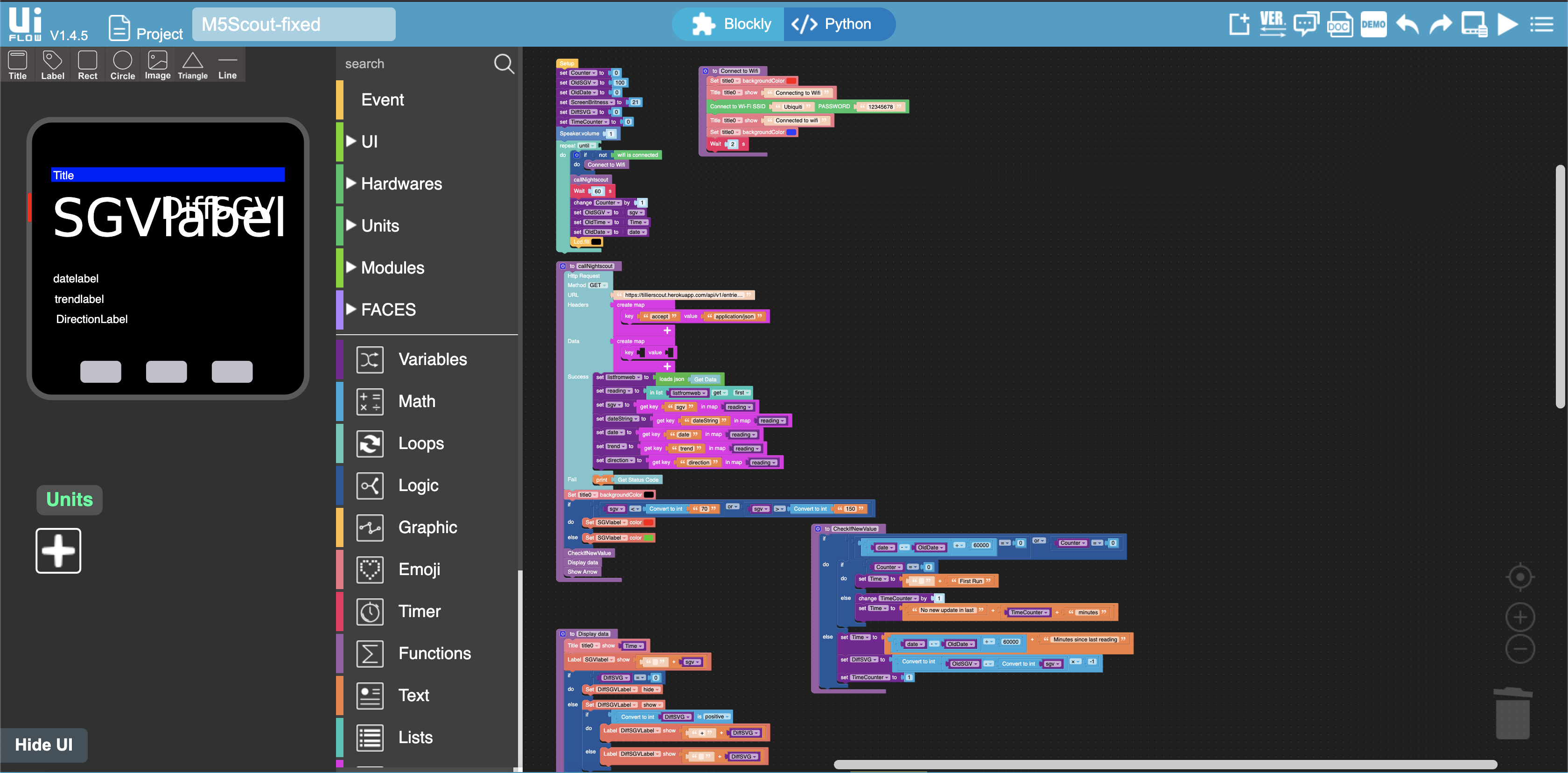

                          Yup. Managed to upload and changed the wifi and webpage data, but somethnig is still screwy.
                          No glucose display, the only thing all 3 bottuns affect is screen brightness.
                          basically my screen displays:
                          SGVIabel (in big letters with DiffSCVI over it)
                          datalabel
                          screen brghtness
                          direction label
                          and nothing I press or do does anything. Wifi did connect and webpage data is correct.

                                "SGVIabel (in big letters with DiffSCVI over it"
                                This usully means that you have the same label set for both out puts or the same screen location for both labels.
