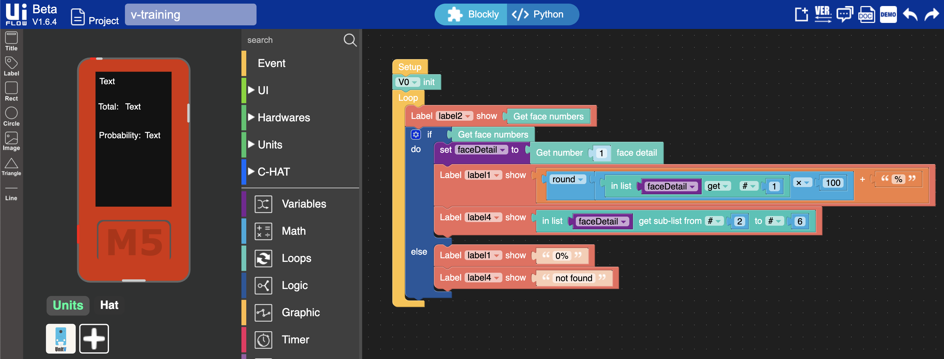

      Just got a Unit-V and was trying to use the face detection V-function. I burned the FaceDetect v1.1 firmware to the Unit-V using the M5Burner. I used the example in the docs (but on an M5StickC-Plus instead of a core) and I can't get it to detect anything.

              Thanks. With the updated firmware, now I have the face detection v-function working now with the example in the docs.

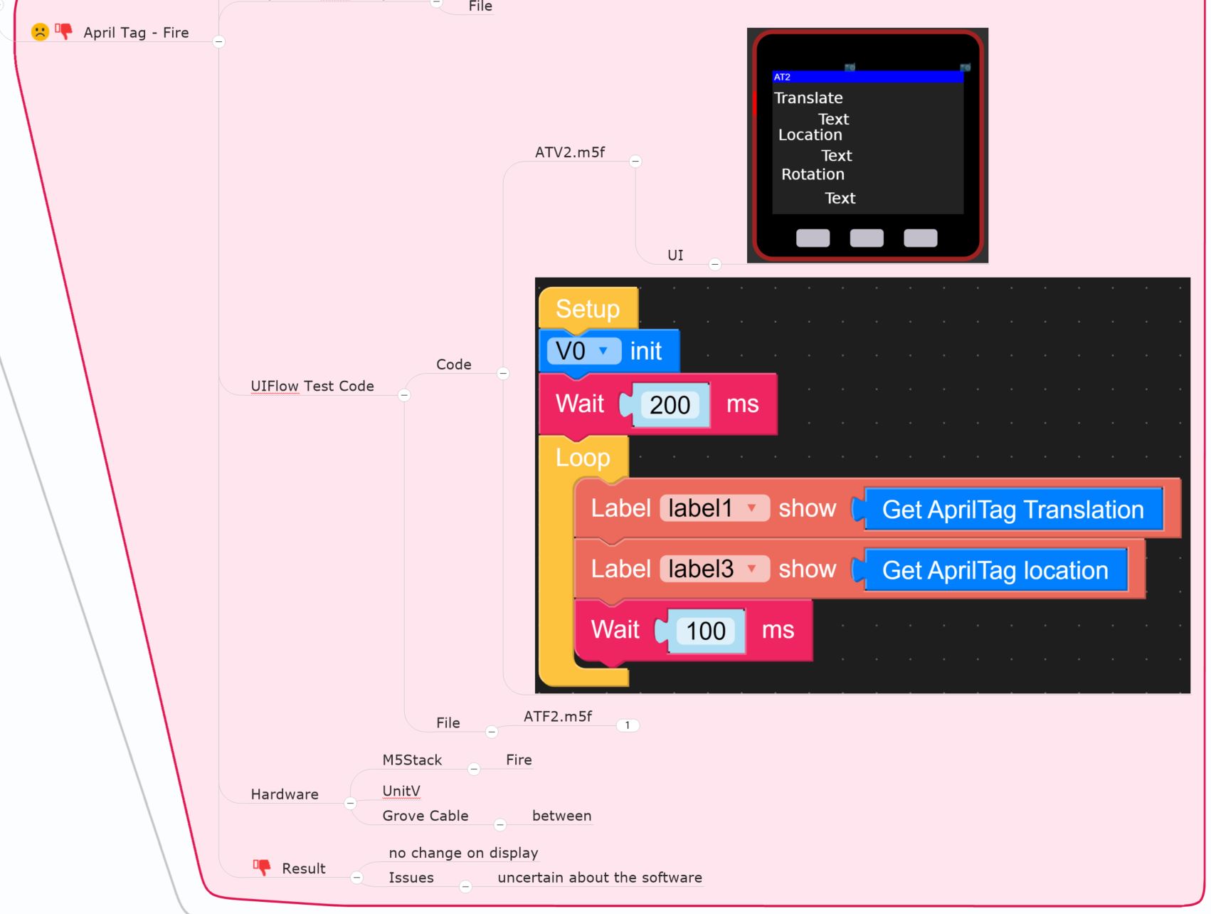

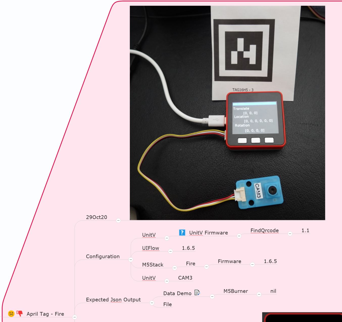

                  @dsrc12 I still can not get any of the code software modules such as Bar code or April Tag to work with either M5StickC Plus or Fire. Here are some of my screen shots.
                  m5stackM 1 Reply Last reply Reply Quote 0
                  • m5stackM Offline
                    m5stack @dsrc12
                    @dsrc12 you could change the tag class. the v-function only supported the Tag36H11
                    D 1 Reply Last reply Reply Quote 0
                    • D Offline
                      dsrc12 @m5stack
                      @m5stack I have tried Tag36H11 images for numbers and this makes no difference. UnitV with M5Stack Fire and UIFlow did not decode the images. I did not make any alternation to my UIFlow code. Did you test this software?
