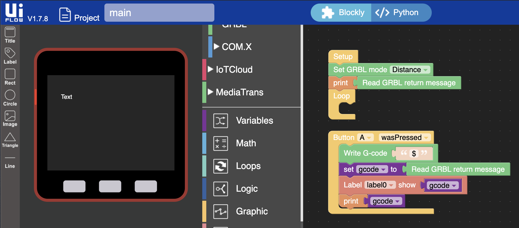

          I used uiFlow firmware v1.7.8 on my Core and also the GRBL uiFlow blocks to serial print the grbl messages coming from the module. It's running 0.8c.

            Would you might sharing your Uiflow blocks on how you serial printed the grbl message?
            world101W 1 Reply Last reply Reply Quote 0
            • world101W
              world101 @ksprayberry
              @ksprayberry
              Here you go...
              Results from the serial monitor after booting and then pressing button A, which sends $ for help:

              Note: I have not been able to connect directly to the module yet (i.e. to type $ for help, $x to set values, etc.). That's why I used button A to send that Gcode command. With the serial monitor (I'm using Terminal on the Mac), you are connecting to the Core (ESP32) and not the ATmega328 on the GRBL module. The Core and GRBL module communicate via i2c at address 0x70 (or 0x71 depending on the dip switch). However, with the blocks m5stack has provided in uiFlow, you can send any command via the Write G-code block. I will continue to experiment, but I would still like to upgrade the module to grbl 1.1 if possible.
