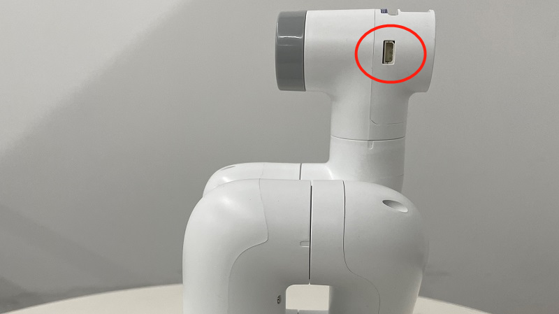

Installing the gripper
1.Fasten the adaptive gripper to the top of myCobot with LEGO Tech pieces.2.Connect the gripper to the end-effector extension interface of M5 Basic.
