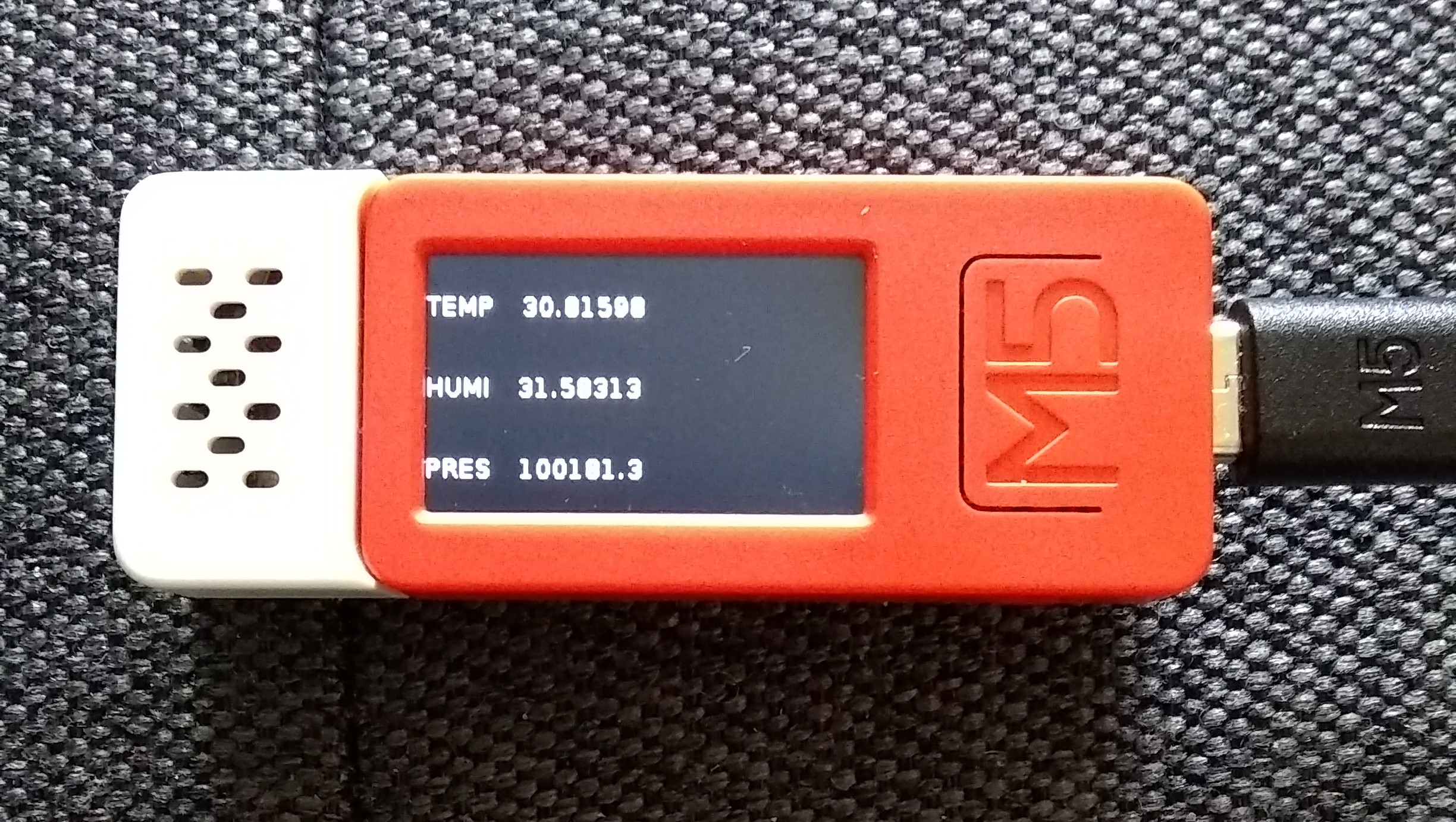

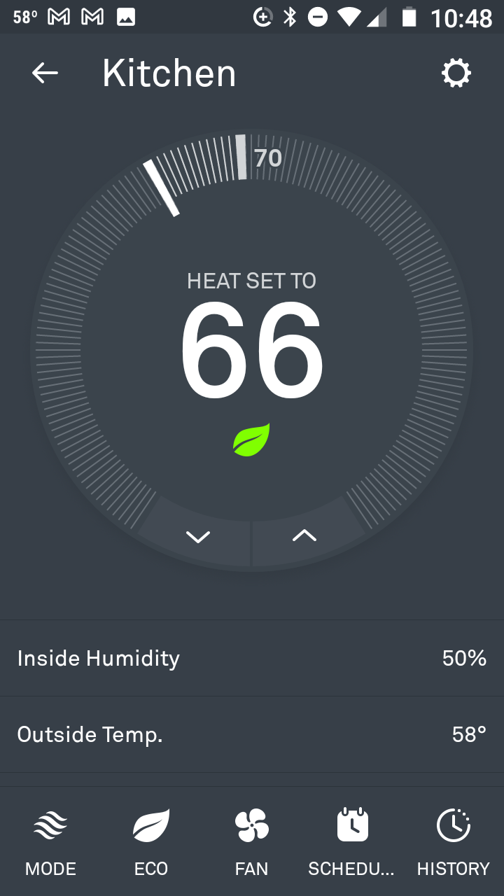

      Why is the ENV3 reading is way off, I attached my thermostat and the ENV3 output.

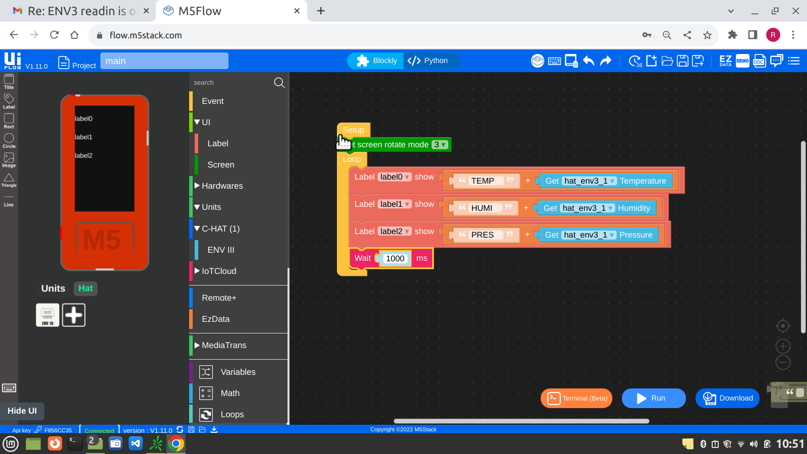

      I was bitten badly using the Desktop IDE (had hard time connecting to flow.m5) not conscience of the missing HAT blocks in IDE, I just click on the '+' symbol under Unit on the left panel, picked ENV3 , went from there and got 'env3 unit maybe not connect' running the example blocks.0_1672849065031_Screenshot from 2023-01-04 10-51-09.png 0_1672849108785_Screenshot from 2023-01-04 10-51-09.png 0_1672849133655_Screenshot_20230104-104855.png 0_1672849167463_IMG_20230104_104622501_2.jpg

        First off- grove is the 4 pin connector on the bottom, hat is the 9pin on the top.
        Desktop IDE hasn’t been updated in over a year but a new version will come out with UIFlow.
        Env hats pick up heat from the stick. R tree he env sensor module used in side of the ENV III needs calibration and tuning, this is done in factory or retail devices but for DIY projects you have to do it yourself so that it fits your project parameter

              Personally, I am not up to the the job of calibrating. Casually thinking about the problem, it nearly impossible to calibrate it. If I use my thermostat to calibrate, it's only good for the first time, once. I notice, the env3 is fluctuating between 18f--33f, while the thermostat is set to around 67-68f With that, I don't have a acceptable target number to go by, only a wild constant but that won't do it. I might as well forget about this ENV3.

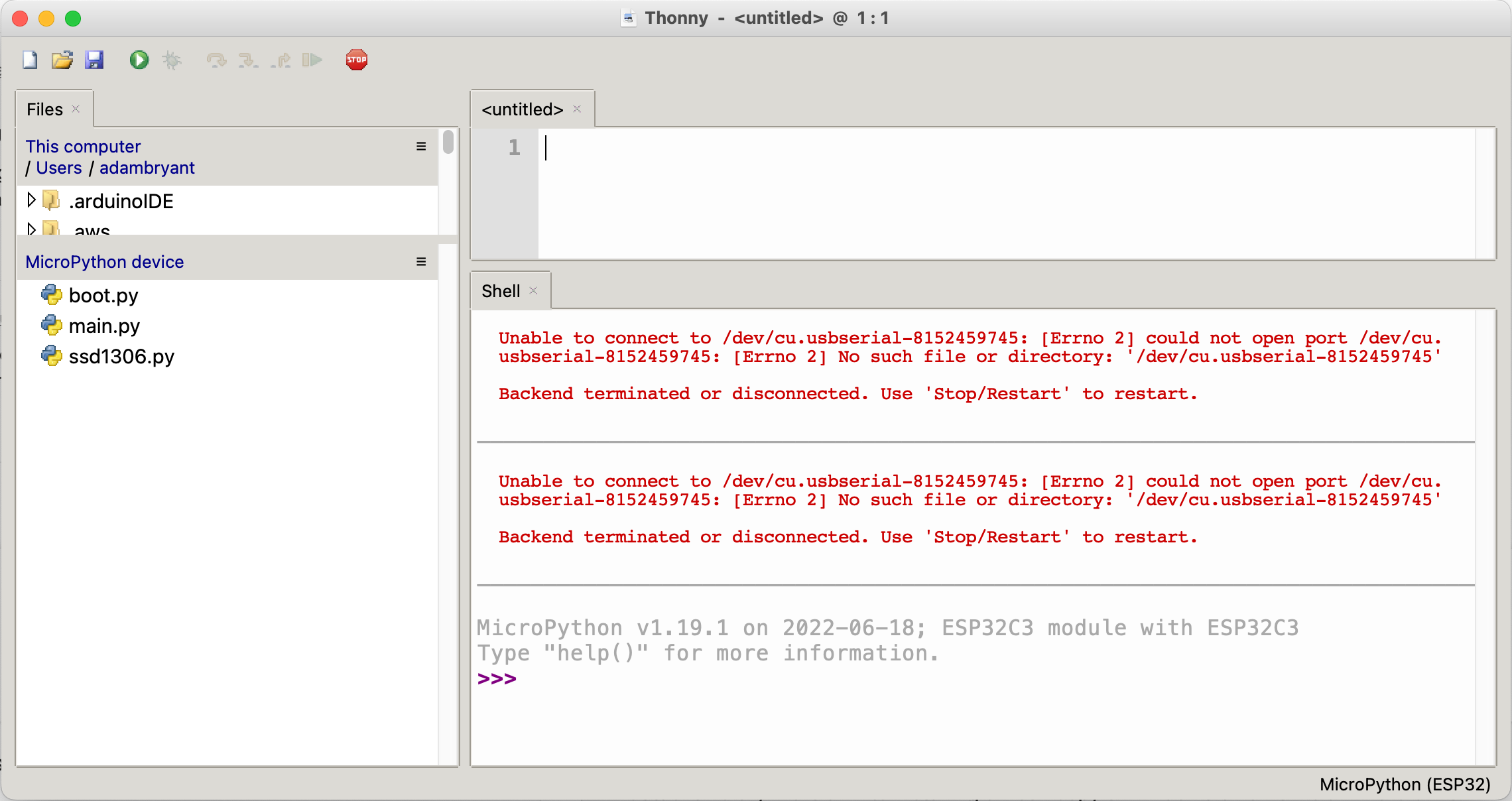

                      I downloaded the ' esp32-20220618-v1.19.1.bin ' and used Thonny to burn it, it wiped the flash before burning but after burning the Stick just wouldn't get up, I turned back to M5burner to get it back up. I don't know how to use esptool to wipe and burn. I seems like I was missing the Micropython or Python itself.
                      I am assuming  that M5burner is as good or better than burning  ' esp32-20220618-v1.19.1.bin '  on it. By using  ' esp32-20220618-v1.19.1.bin ' did  I miss out on some needed utilitie  that causes the Stick to sleep.

                          What you did was to install mainstream micropython. this is different from UIFlow's version as it contains only the core micropython without M5Stacks library more akin to installing a fresh copy of windows on a new blank hard drive.
                          The versions in M5Burner are tailored specific to M5Stack devices and contains the "drivers" needed to run M5Stack.
                          Does this mean that you can use mainstream Micropython, no.
                          As you are still at the beginner stage of learning, you are better off with the M5Burner version. The Mainstream version is for use from within Thonny once you know what you are doing.
