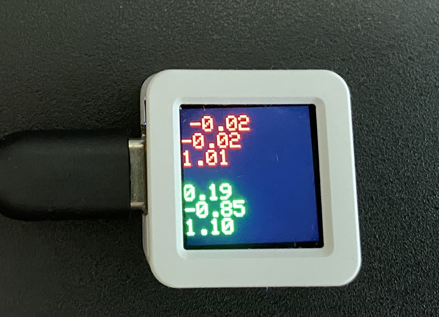

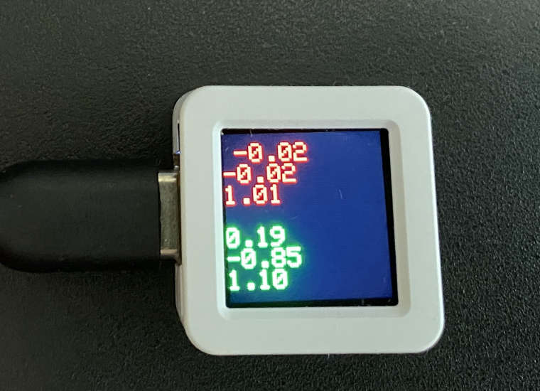

        @drew-p Simple answer to any IMU:
        Just put it flat on a surface. The axis that shows ~ 1.00 is 1 gravity, the others should be ~ 0.00
        Shown here is the AtomS3 built-in IMU with the third reading (az) showing "1g" .
        You can roll it on its side to see x or y.
        Hope this helps.

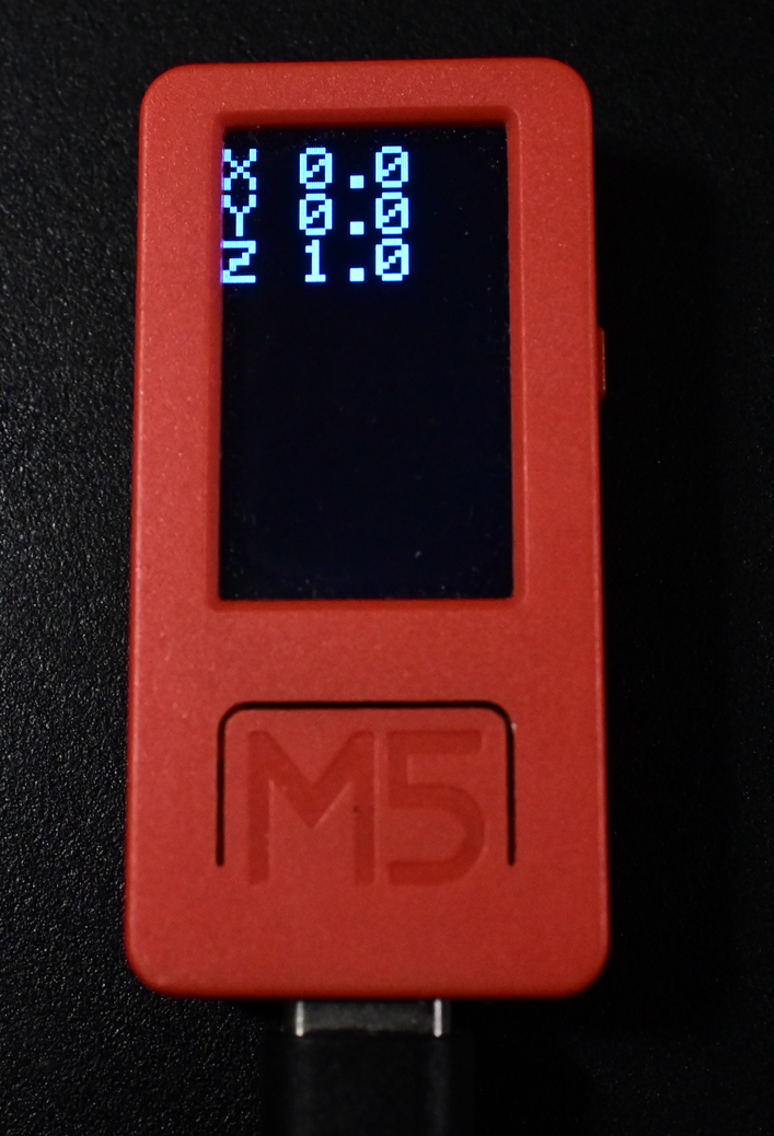

              My advice works on any IMU on any microcontroller.
              You can figure it out yourself, it's fun and part of the challenge.!0_1674873297510_StickIMU copy.jpg
              Lying flat on the bench, "UP" (towards the camera) is Z axis. Rotate to side and on end to determine other axes.

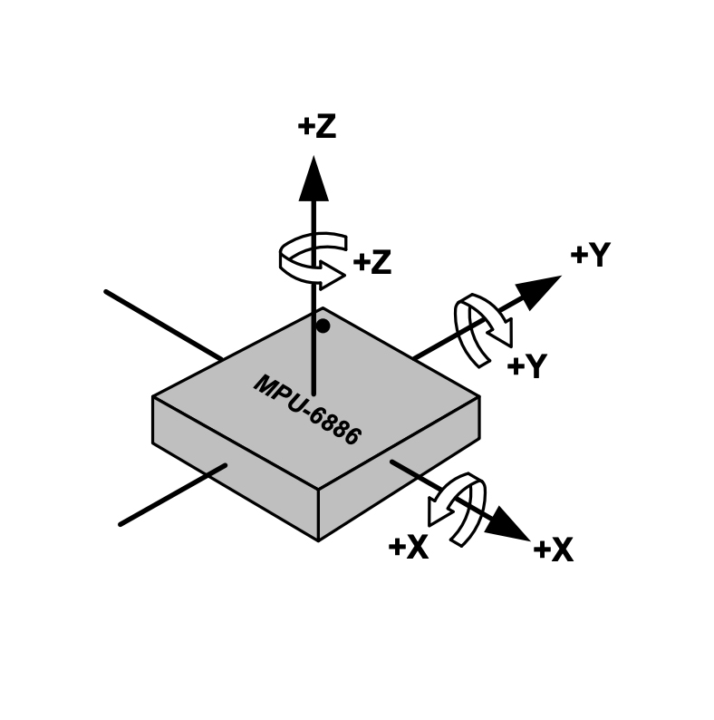

                  @drew-p From the IMU mfg. website:
