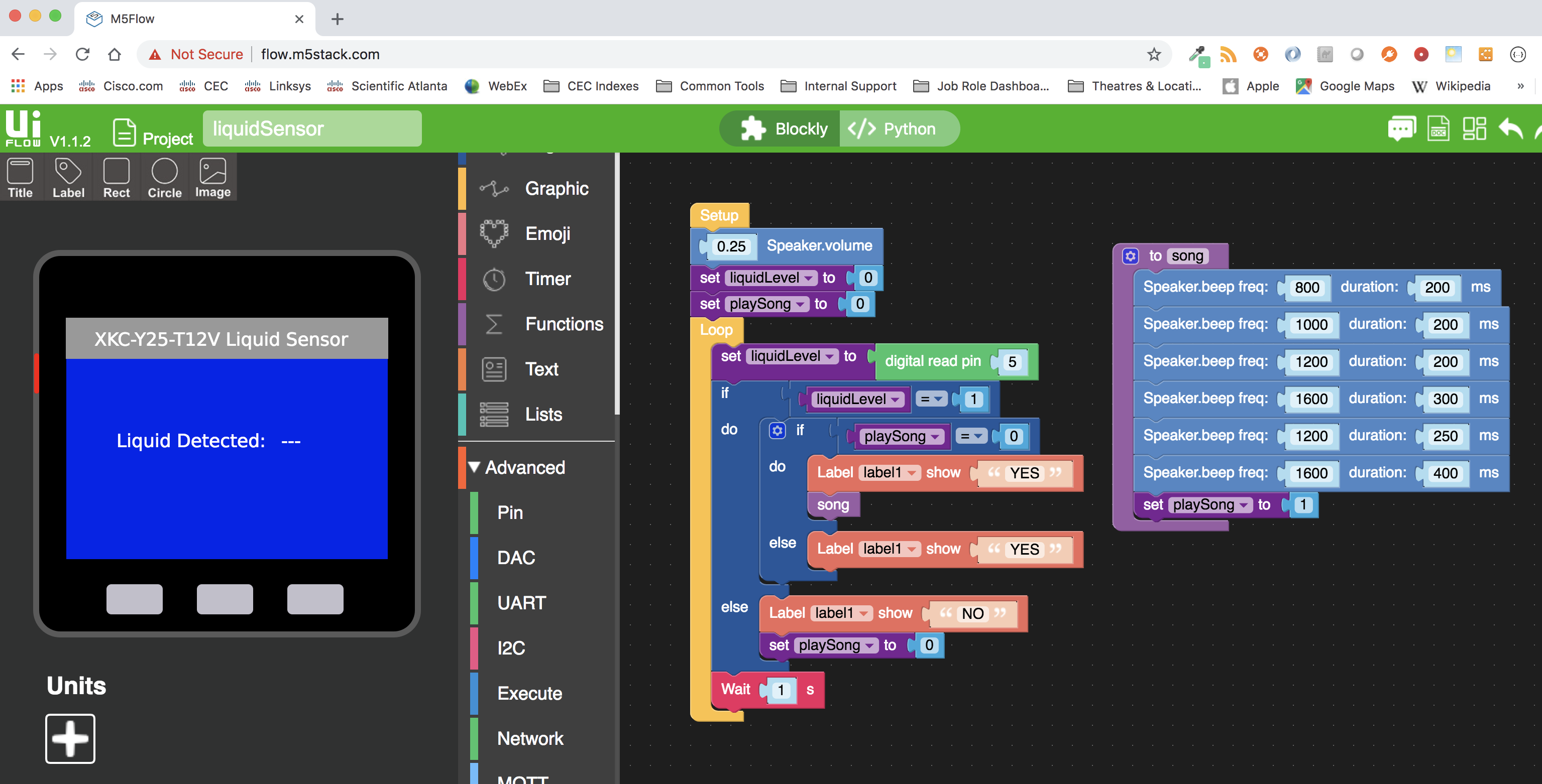

      With the new V1.1.2 firmware today, it seems that we've lost the ADC functions under the Advanced menu. I think it is causing issues with my flow.

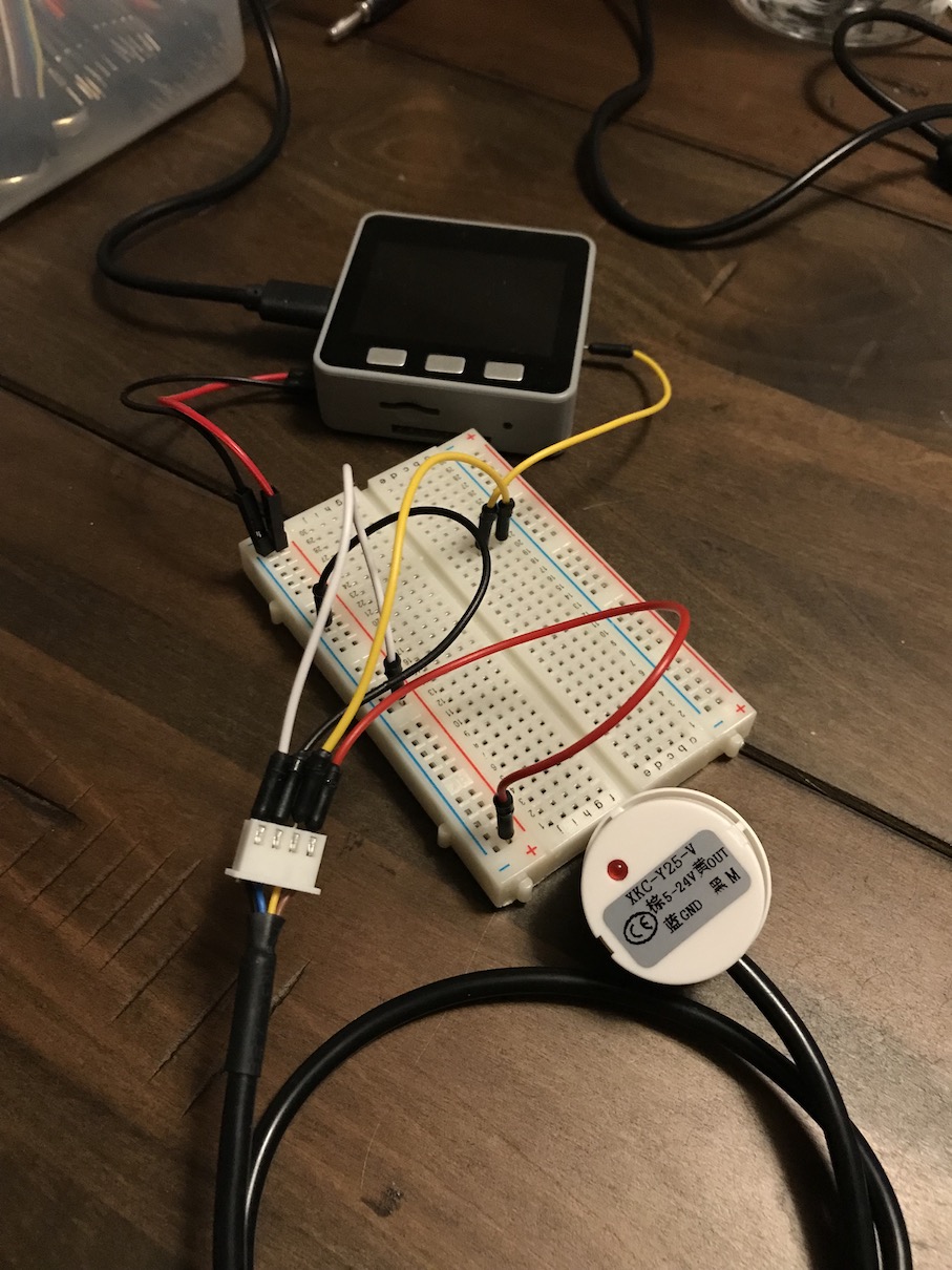

      I'm trying this simple flow with a non-contact water sensor (XKC-Y25-T12V).
      I could be doing something wrong, as this is my first attempt at creating a uiFlow from this Arduino example sketch:
      https://www.dfrobot.com/wiki/index.php/Non-contact_Liquid_Level_Sensor_XKC-Y25-T12V_SKU:_SEN0204
      I have VCC (brown) and GND (blue) connected between the water sensor and the m5stack. Then I have the OUT pin (yellow) of the water sensor connected to G5 (GPIO 5) of the m5stack (grey bottom). Finally, I have the ADJ pin (black) connected to GND. The sensor is working properly. I fill a glass of water about half way full. When placing the sensor on the side of the glass above the water, the LED on the sensor is off and the voltage reads 0V on my multimeter. When I slide the sensor down to below the water line, it detects the water, the LED on the sensor turns on, and the voltage reads about 4.75V on my multimeter.
      Upon uploading to my m5stack grey core, I get this error:
      AttribueError("type object 'ADC' has no attirbute 'OUT'",)
      Any ideas? I'm no sure if uiFlow has a bug or my program.

        After some trial and error, I figured it out. A few changes I made:
        • Removed the "Set pin" block. This allowed the flow to compile without error.
        • Connected the ADJ pin (black) to VCC instead of GND per the sensor datasheet.
        • Added an audible tone function to the flow so a song will play when the liquid is detected.
        • Updates to the UI interface
        I'm still not sure why the ADC causes an error when the Set pin block is inserted. @heybin or @watson, perhaps you can look into that.

                      I would try your tests, but unfortunately, I don't have the Earth sensor from M5stack. I have a few things on order (Relay unit, hexagon neopixel unit, etc.), but the Earth unit is not one of them. I only have the water sensor I linked in my first post, model XKC-Y25-V. It's not from m5stack. Here is a link to a better datasheet.
                      http://www.naylampmechatronics.com/img/cms/Datasheets/XKC Y25 T12V.pdf
                      I just wire it straight to my m5stack core using jumper wires. The yellow wire goes to GPIO5 on the bottom of my m5stack grey.

                              I tried to wire my breadboard jumpers to port A of the Fire, but they didn't fit too well (2.54mm vs. 2.00mm pin pitch). I will have to wait on my shipment of Grove cables from Aliexpress. Also, it looks like you have the ADC unit and the Earth unit both defined on port A. uiFlow didn't like that.
                              So instead of trying to use the Unit functionality within uiFlow, I wired up the m5stack Grey again and used the Micropython console. This code works with my liquid sensor:
                              from m5ui import *
                              clear_bg(0x111111)
                              pinin = machine.Pin(5, machine.Pin.IN)
                              btnA = M5Button(name="ButtonA", text="ButtonA", visibility=False)
                              btnB = M5Button(name="ButtonB", text="ButtonB", visibility=False)
                              btnC = M5Button(name="ButtonC", text="ButtonC", visibility=False)
                              label0 = M5TextBox(136, 127, "Text", lcd.FONT_Default, 0xFFFFFF)
                              while True:
                                  val = pinin.value()
                                  label0.setText(str(val))
                                  wait(0.1)
                              It reports a 0 (no liquid) or 1 (liquid detected) on the m5stack LCD.
