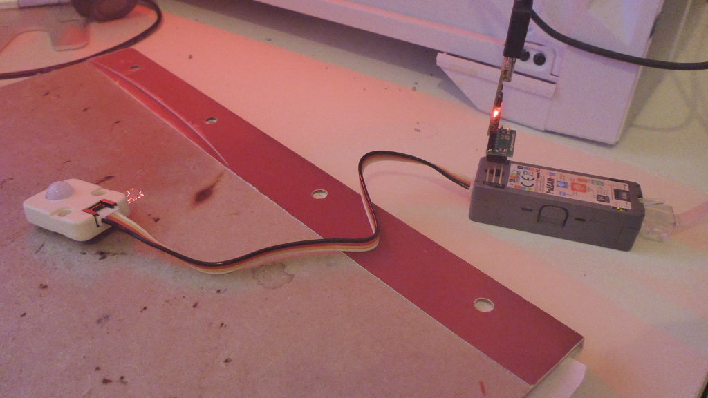

          I'm not being foolish the wiring is as simple as (ignore the solder) :

              In the factory test I see the references to UART Ext_PIN_1 and Ext_PIN_2 :
                Serial.println("UART INIT");
                uart_init(Ext_PIN_1, Ext_PIN_2);
              which is defiend in timer_cam_config.h
              #define Ext_PIN_1 33
              #define Ext_PIN_2 25
              So lets strip off the header and run it with the pure Arduino.
              #include <Arduino.h>
              void setup() {
                 pinMode(33, INPUT_PULLUP);
                 Serial.begin(115200);
              void loop() {
                 Serial.println(digitalRead(33));
                 delay(1000);
              It works but only if I set the board to M5Stack-Timer-CAM.
