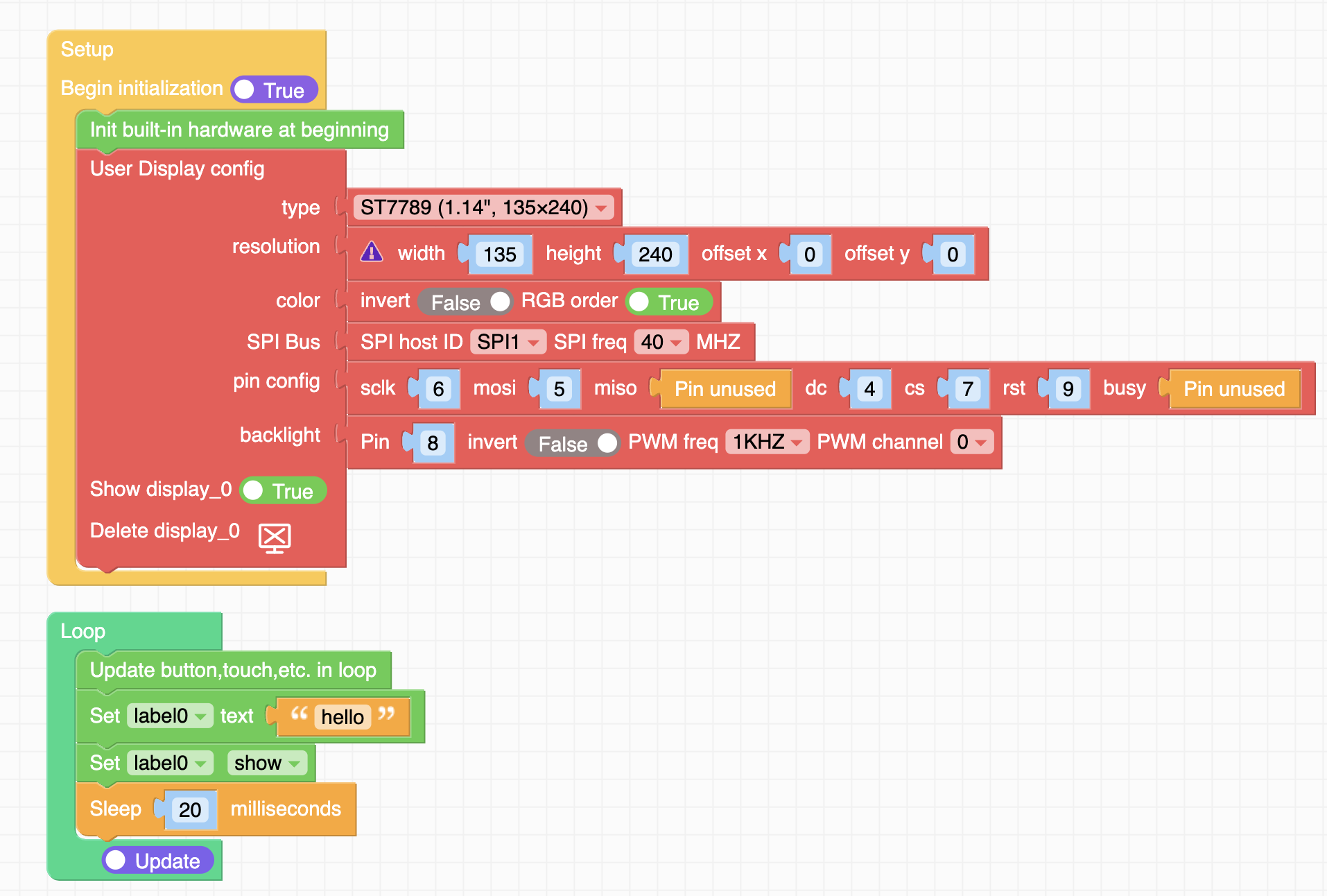

      I cant get an SV7789 SPI display working using the following code in UIFLow2

        check out my example M5StampS3_LCD_ST7789V2_UIFlow2.0.2 in the Play Zone. It looks like the backlight PWM part is not working properly, e.g. the display stays dark. I fixed that by setting the backlight GPIO to HIGH manually.

            for me the display only works when selecting SPI host ID SPI3.
            BTW: I just figured out that PWM actually works, but the default brightness (127) is too low to see. Using st7789.setBrightness(255) sets a visible brightness.
