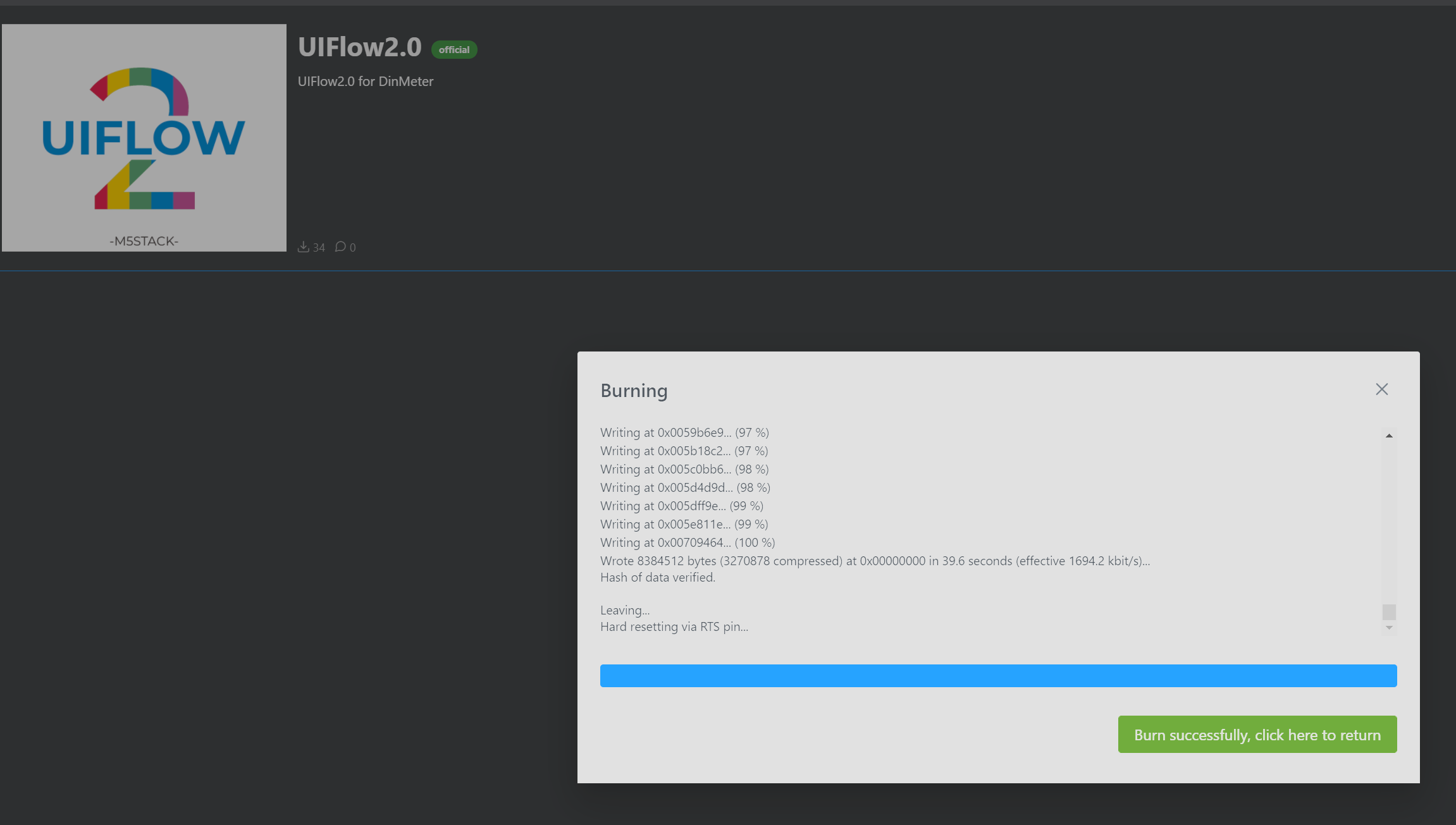

      `I have an M5DinMeter.
      I burned the firmware using the M5 Burner to use UIFLOW.
      I get a message saying successful, but nothing is showing on the screen of the M5DinMeter.
      DiaMeter Demo worked well.
      What should I check?

          Press reset on the din.
          Did you burn the correct version of iiflow2 and did you erase first
          S 1 Reply Last reply Reply Quote 0

            • S
              seungmin @ajb2k3
              @ajb2k3 I did erase first, and burn version 2.0.4 of UiFlow2 firmware for DinMeter. I reset it after the burn is complete, and it still doesn't show anything on the screen. I tried writing a simple program on UiFlow2, but it didn't work.

                • S
                  seungmin @felmue
                  @felmue Thank you for your answer.
                  I erased and burned the firmware 2.0.4 hotfix version several times and it worked. I don't know why it suddenly started working. I just repeatedly erased and burned it.
