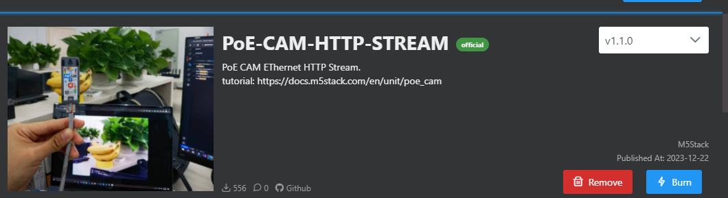

        if you have this firmware burned:
        You should be able to get the video stream on http://<Cam-IP> or http://<Cam-IP>/stream
        This firmware is setup by default to ask for an IP on DHCP.

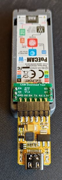

        Since there is no USB port you'll need a small adapter like this to burn the firmware on to the PoECAM.

          • C Offline
            Cognitive5525
            Assembled and connected like this?

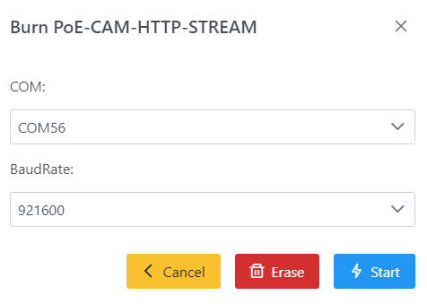

              And sometimes you need to lower the baud rate when burning:

                I tried all the baud ratings, I did not connect like that I used the cables as I didn't want to solder. Do i need to use the piece?
                C 1 Reply Last reply Reply Quote 0
                • M Offline
                  mikecre
                  I was able to get it working using the piece. I'm not sure how the the way this comes really makes it easy... couldn't that board just come pre soldered on? Instructions could def be much more clear imho but i'm also a newbie to these types of devices.

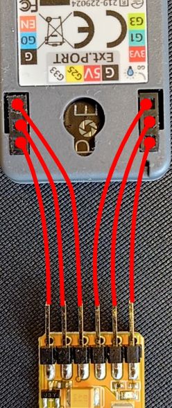

                    @mikecre said in M5 PoECAM-W Stream help:
                    There is nothing magic about the small extra board. it should be same if you connected your jump wires like this:
