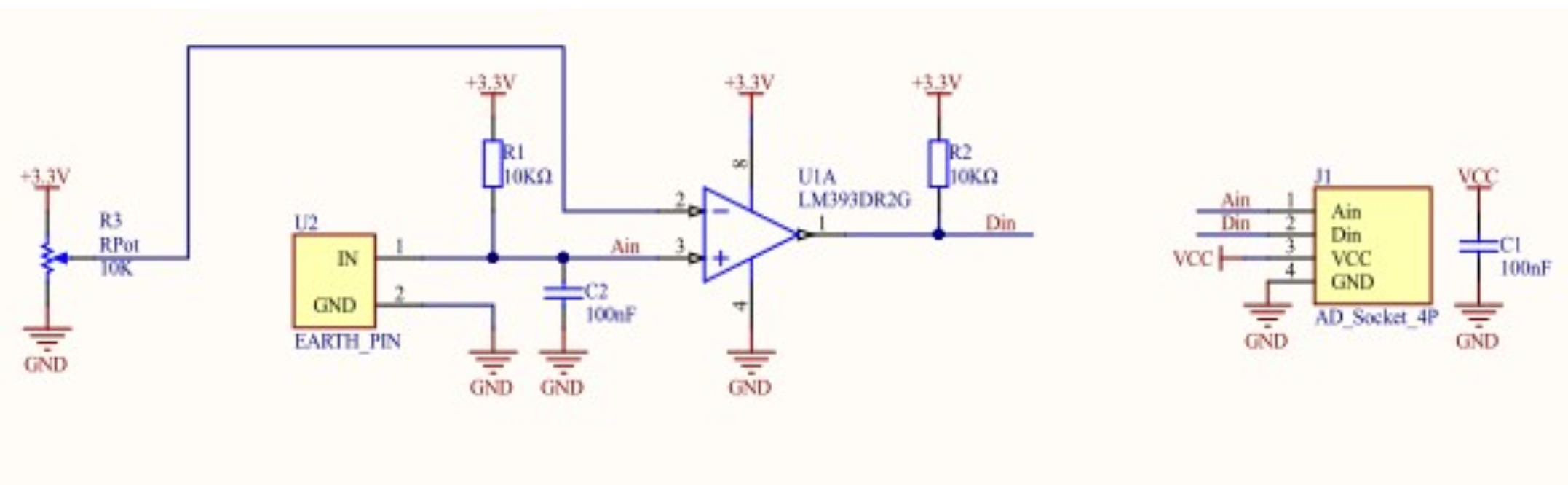

        from the docs page
        https://docs.m5stack.com/en/unit/earth
        you can see that the 'Ain' just reads the voltage across the sensor and the 'Din' is at least the threshold comparator, adjusted by the trim pot on back.
