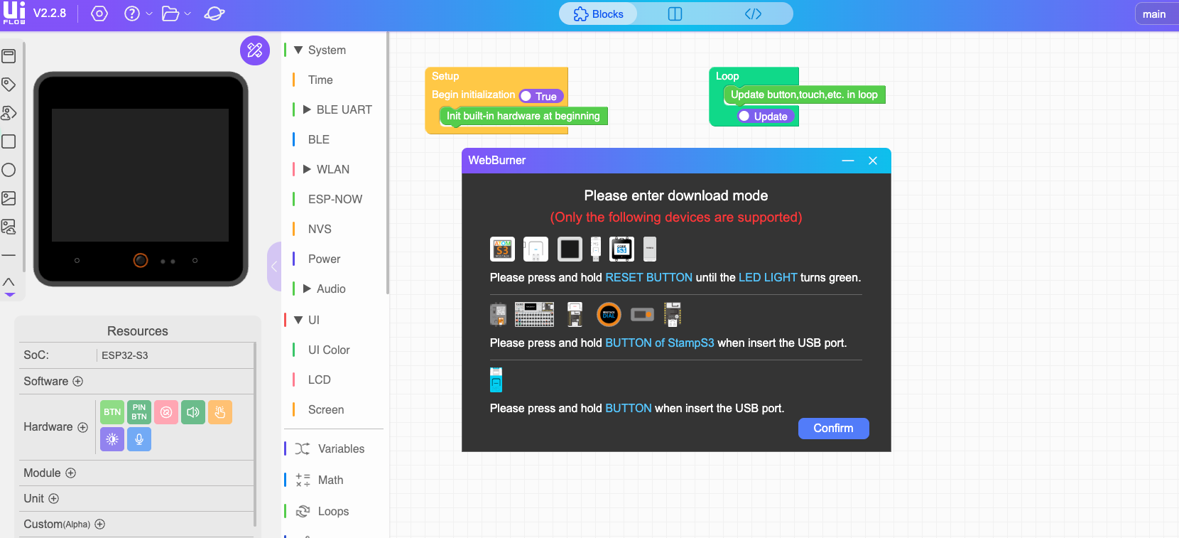

              you can also burn the UiFlow 2 firmware using webburner (located at the left down corner of UiFlow2)
              V 1 Reply Last reply Reply Quote 0
              • V Offline
                visevision @kuriko
                @kuriko this would be a nice option, but if i choose the webburner and select the AtomS3 then there is no firmware I can select/burn. All AtomS3 Versions show nothing in Firmware, all other do.
