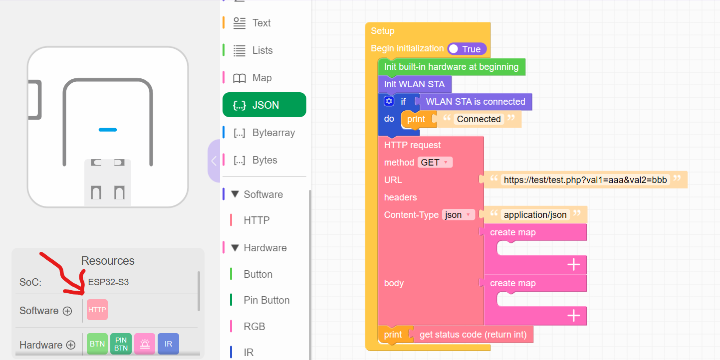

        Hi,
        Example in MicroPython:
        def setup():
          global wlan, http_req
          M5.begin()
          wlan = network.WLAN(network.STA_IF)
          if wlan.isconnected():
            print('Connected')
          http_req = requests2.get('https://test/test.php?val1=aaa&val2=bbb', headers={'Content-Type': 'application/json'})
          print(http_req.status_code)
        And UI Flow2
