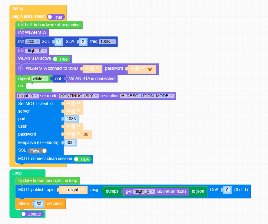

RE: Atoms3 lite with Dlight Unit to MQTT_ Not workingposted in PROJECTS
Thank you felmue for your assistance.
I have managed to get this working and the light readings are now passing through MQTT to my HA.I added the "dump (reading from the dlight unit) to json block" and all is working now.
Well this has been one of those projects where I have spent hours and got nowhere.
Can anyone tell me why this UIFlow2 program is not working. By not working I mean I am getting no messages (light readings) published to my Home Assistant EMQT server.
