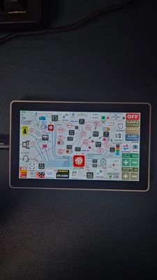

It is happening on just 2 Tab5s that I bought a week ago.
And I flashed all versions of UiFlow2 firmware onto these 2 devices. But I found the same issue on display of Tab5.
But, If flashing Tab5 User Demo f/w onto these devices, then these devices are displaying normally.But, It isn't happening on the Tab5 that I bought about 2 month ago.
(Of course I used same f/w version and flashing method.) -

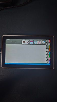

I bought a Tab5 two month ago.
So, I flashed UiFlow2 firmware with M5Burner.
After flashing firmware, I designed my UI with UIFlow2.0 IDE and ran it normally. it was perfect.So, I bought 2 more Tab5s a week ago.
And flashed the same UiFlow2 firmware(v2.3.7) and coded some simple UI components like Button, Label, etc with UIFlow2.0 IDE.
But, Tab5's display is not showing anything other than a slight flicker.Anyone having the same issue?
