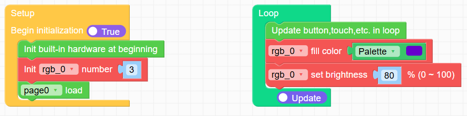

      I was trying to use a RGB unit with Port A in firmware V2.3.7 for Core 2but the RGB unit just doesn't illuminate. I read in a post created by @Handcannon (https://community.m5stack.com/topic/7829/uiflow2-0-tab5) that Port A is not receiving power in V2.3.7 and V2.3.6 for Tab 5 but V2.3.6 Hotfix worked.
      I tried it and it didn't work as I assumed the firmware would have the same handling for Port A. I have now tried Core 2 V2.3.4 to V2.3.7 and none of them work. Any help would be much appreciated!

        hmm, I've tested M5Core2 v1.1 and RGB with firmware v2.3.7 in UIFlow 2.3.7 and it works for me. No power issue at all.
        You can find my example in the UIFlow2 Project Zone: M5Core2_RGB_Test_UIFlow2.3.7
        Thanks

          @felmue Thanks so much for your help! I tried your example which runs fine on my Core 2 but still the RGB Unit doesn't show any light. I have tried a second one but I received no further results. I am currently trying a new way of powering the RGB Unit by importing the RGB Unit through the Unit selection menu and then using those blocks.
          But that doesn't seem to help either. I assume that in the new firmware, M5Stack hasn't removed the ability to use port A as the port for the RGB Units as I found that they could only be powered by port B in UiFlow 1. I have several other grove cables that I am going to try and then also test to see if any other units work through port A (like CardKB and ENV III) and will send any further information if you would like.

              how many RGB LEDs are connected to port A? The flicker could indicate that port A is overloaded if too many RGB LEDs are attached.
              Also, how do you power your M5Core2? Via USB-C or battery or other?
              BTW: My test was with 6 RGB LEDs.

                I was trying it with 3 leds (The standard unit) and it is powered by the standard USB C cable that comes with the Core 2.

                  When you add the RGB unit did you choose port A? By default port B is selected which uses different GPIOs.
                  Also, just to make sure, you did connect the input side of the RGB unit to M5Core2 port A, yes.

                    I did select the Port A for the RGB Units, I have tried connecting it to both sides but neither work... That is the same with both RGB Units.
