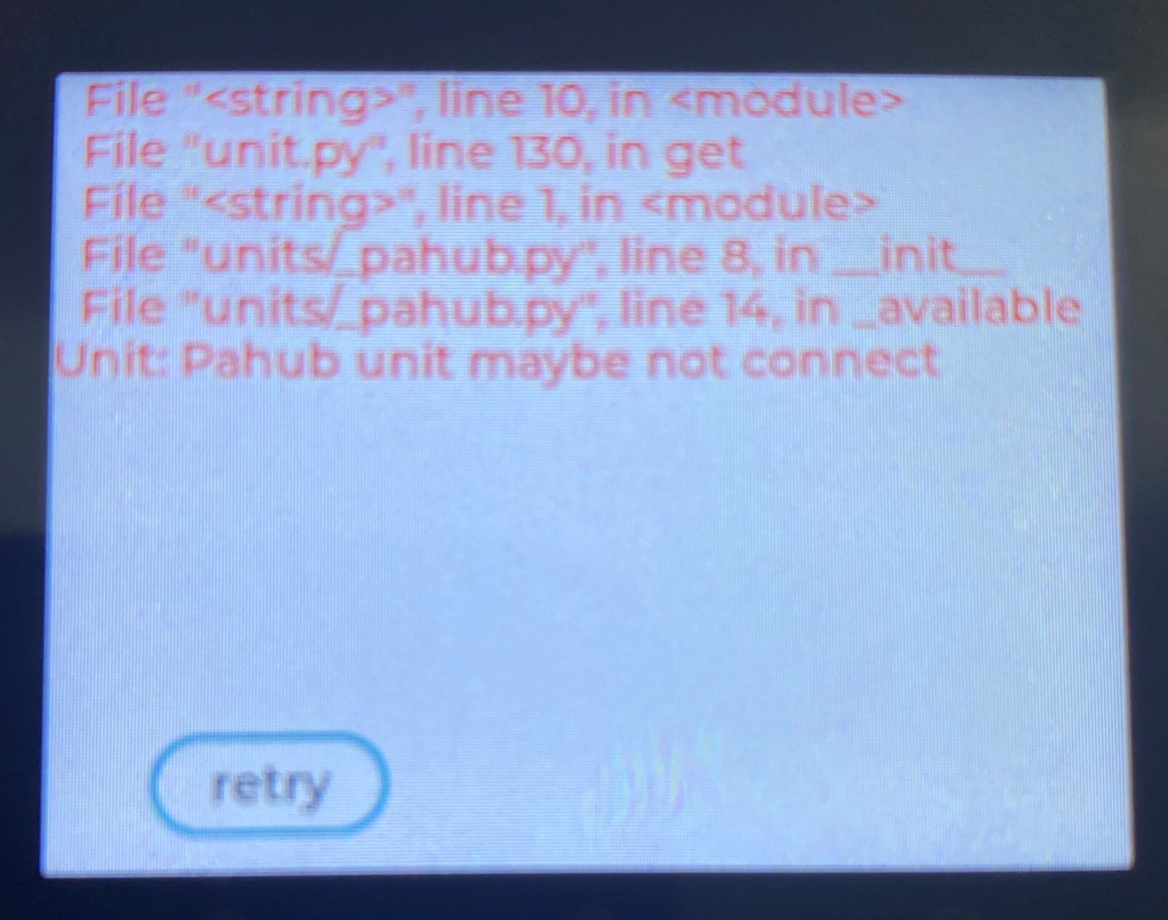

      I have a PAHub not connected error if I use a GOPLUS2 with my CORE2. The Pahub works perfectly, then if I add the GOPLUS2, I have a Pahub not connected error.
      I tried to change the I2C address to 0X71 or 0X75 without success ...0_1612029359667_IMG_5732.JPG

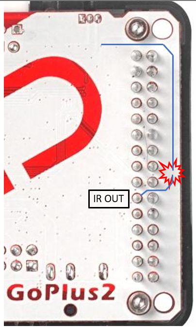

        That said, looking at the GoPlus2 schematics there is an MBus pin used for IR_OUT. On M5Stack devices that pin is GPIO5, however on M5Core2 that pin is GPIO33 which on M5Core2 is also used as PA_SCL. The I2C bus operates with pull-up resistors on SDA and SCL lines, but the IR_OUT circuit in GoPlus2 has a pull-down resistor on GPIO33. My guess is that the IR_OUT circuit interferes with the I2C operation.

            If my analysis indeed is correct and IR_OUT in GOPLUS2 is the reason I2C stops working properly on port A, then for the units you'd like to connect to the M5Core2, I personally would modify the GOPLUS2 and cut the trace from GPIO33 to the IR_OUT. With that one modification you'd regain the functionality of port A. Then with the help of the PaHub this should cover the TOFs, Ultrasonics, AMmeter and Voltmeter units. I assume the Relay unit can be connected to the GOPLUS2. The NeoPixel I don't really know. The battery bottom for M5Core2 uses GPIO25 for that, so I guess that would work. How to connect to GPIO25 w/o soldering I have no idea.

              I took your advice # 1 by turning off IR OUT and it works wonderfully. thank you again for your help, it allows me to progress quickly.

                      @arno Hi, Arno, thanks for the reply, but the 'cut' here means physically cut the wiring on the PCB board?
                      is it fine if we physically cut it on the board (there might a big chance to damage the board)?
                      ArnoA 1 Reply Last reply Reply Quote 0
                      • ArnoA Offline
                        Arno @LishengKKK
                        @lishengkkk all it takes is a small stroke of the cutter and the track is cut cleanly.
                        I scraped off the white paint to get to the copper. So if needed a drop of solder and everything works as it did at the start.0_1649879088139_Afficher les photos récentes.png
