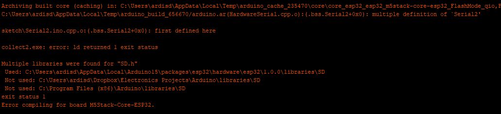

      I have recently changed to using https://dl.espressif.com/dl/package_esp32_index.json in the boards manager now any application using serial2 wont comple. I get an error Error compiling for board M5Stack-Core-ESP32.

        @ardisd Can you post a screenshot of the error ouput from arduino?
        • A
          ardisd
          Enclosed screen shot as requested
          I get the same error when compiling Serial2.ino and my own code

            Are you running arduino 1.8.7?
            Thats not all the error.
            • A
              ardisd
              Upgraded to 1.8.7 was on 1.8.5
              This is the error now

                I first thought is to tell you to Backup and delete the SD folders in dropbox and
                C:\programfiles(x86)\Arduino\Librarys\SD
                and then try again.
                Can I see your source code?

                  • N
                    nnn
                    I got the same problem.
                    I changed the rename of Serial2 and fixed it.
                    HardwareSerial Serial2(2);
                    →HardwareSerial Serial2_(2);

                      @nnn 在 Serial2 Don't compile 中说:
                      Thanks
                      That worked for me
