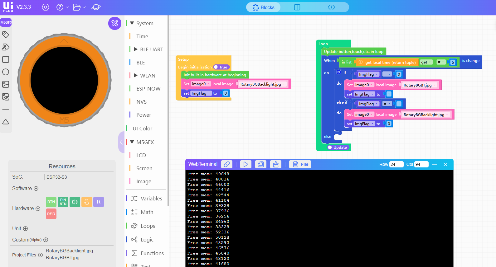

      I used UIFlow2.3.3 to develop a simple UI demo. There is only one image widget to switch 2 JPG images every second. When I monitor the memory with gc.mem_free, I found the memory reduced continiously. And finally, the image switching was stop, but the loop was running. I wonder how to solve the UI memory leak? Here is my python code:

      And my UIFlow2 design:

        zhumingqi @zhumingqi
        I tested more UI design. And I found that the memory leak only happens when I use image component and switch images frequently. Is that a UIFlow2.3.3 bug or my design is incorrect?
