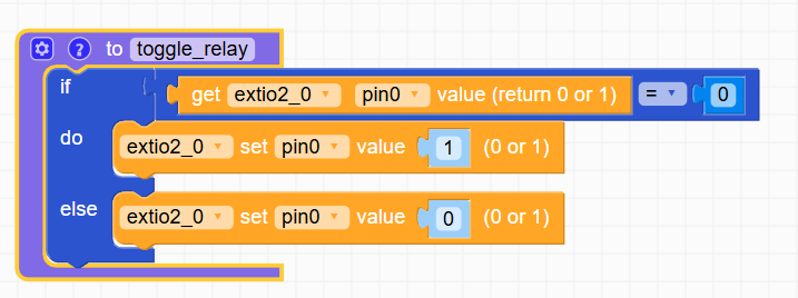

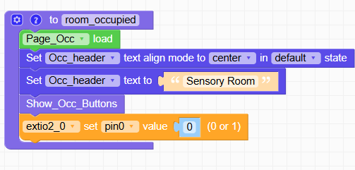

Thanks Felix, I updated the TAB5 to V2.3.6-hotfix2 but the problem remains. As a trest I write once a second and that works, when I then call it in another function it panics
This code panics
This code works
Any help would be appreciated -

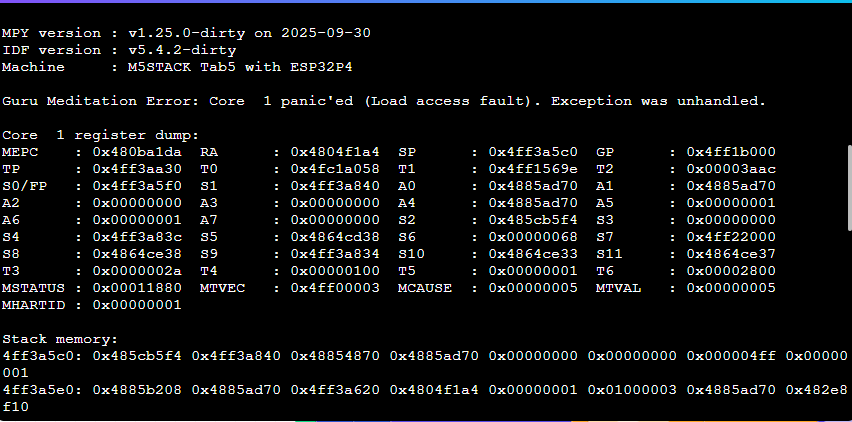

TAB5 python Crash
I was trying to write an output on EXTIo2 and I got a python crash and a dump.
I then tried to update the TAB5 to V2.3.6-hotfix2.
The device programmed and the default UIFlow screen is showing, but now I cannot program the device.
I reverted to 2.3.5 and I can program the TAB5 -
M5Tab fatal error
I am now working with M5UI, and I am getting a core panic. The message is. The device resets and then the application runs, but the terminal has disconnected and print to the terminal no longer works.
Surely I shouldn't be able to create a core panic using UIFlow2?
