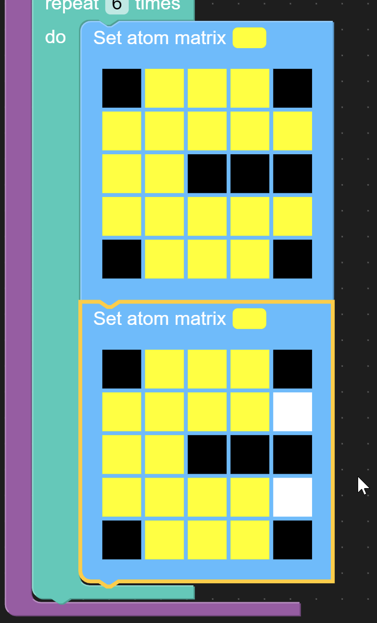

  • Set Atom Matrix block duplication bug - color reverts to white
    0 Votes
    2 Posts
    4k Views
    RIDDSprojectsR
    Hello, It helps to select a different color first. Then you can still make copies. An annoying detour indeed.
